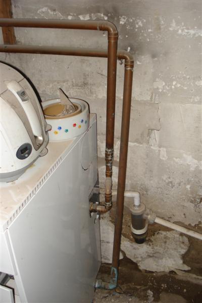

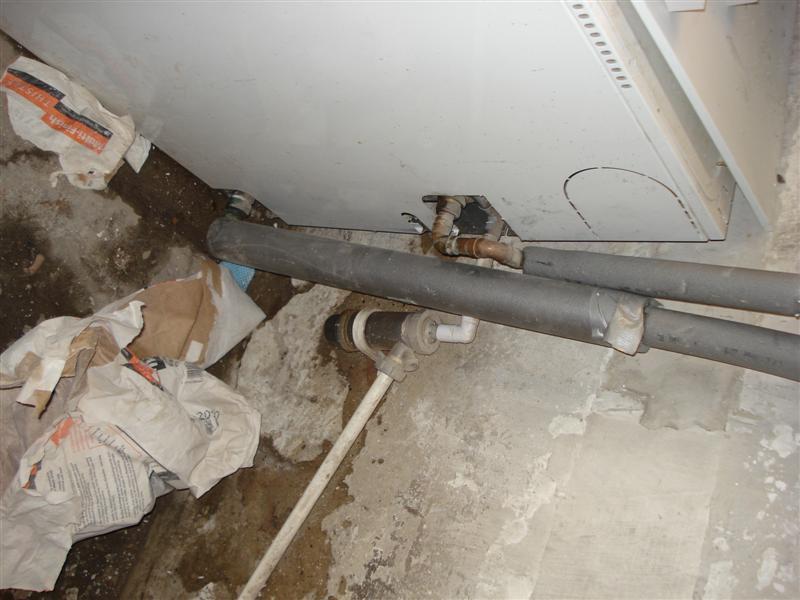

I only have this picture of boiler to hand (non pump side)
distance between feed and vent connection should not be more than 150mm
not sure about this?
[/img]

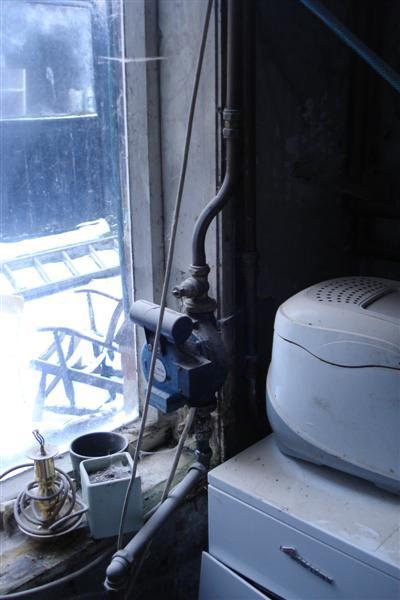

edit found another picture of the other side ( I have since changed the pump to a more modern one)

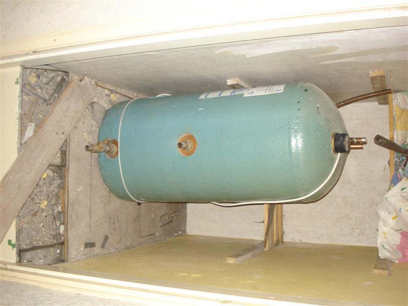

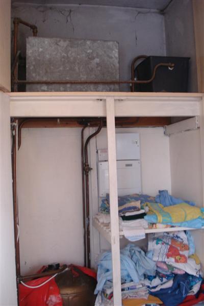

Old tanks I have new hot water and cold water tank to replace these decrepit old ones.

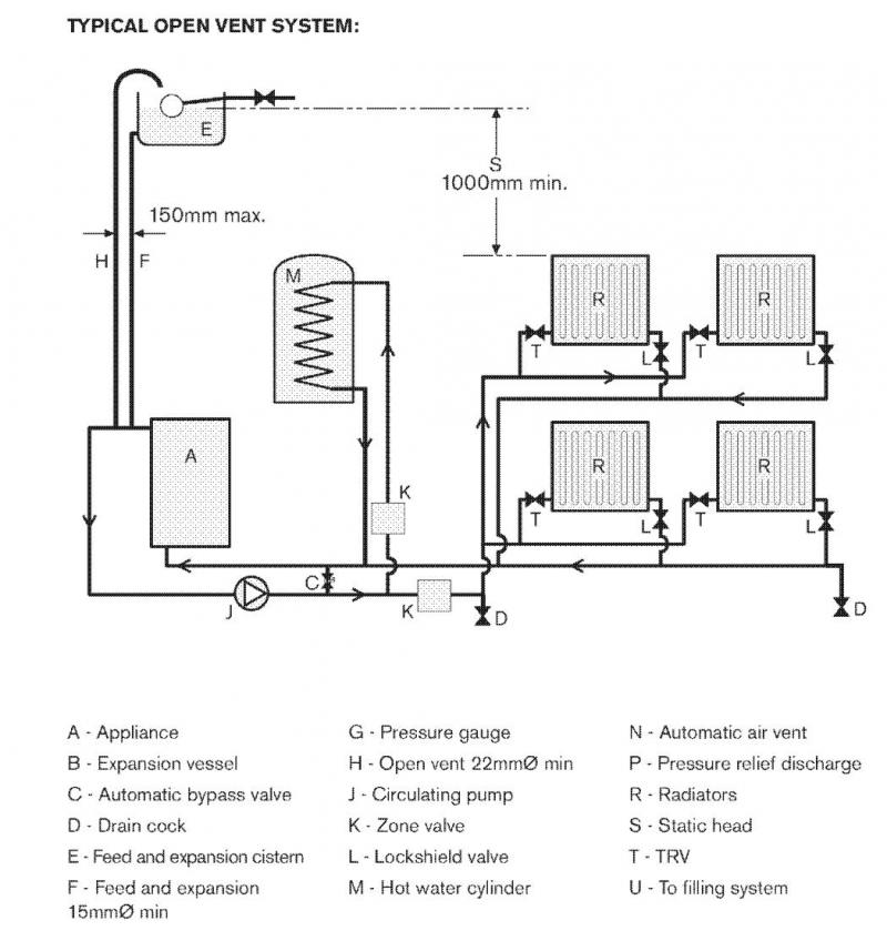

I was not referring to the rising main but to the connections from the F&E tank to the heating circuit. Check out this diagram:

That diagram does not have a F&E tank or is it and F&E tank without cold water cistern.
I have two tanks and its just which pipe goes where!
My plumber said I would need to block off one of the 28mm pipes exiting the boiler on the right hand side, I assume this is feed and return for hot water and the 22mm pipes the other side are for the CH?

The tank shown in the diagram is the F&E tank. The diagram does not show the cold water supply to the tank, just the feed from the tank to the system and the vent pipe..
Read the 18/25 Installation Manual

Do you mean the Hot Water cylinder? If so, both pipes will have to be removed. One connection (22mm)from the HW cylinder will go to to the outlet of the HW motorized valve. The other connects (22mm) to the return pipe from the central heating to the boiler. It must be the last connection, after all radiator connections, and have a gate valve on it so the HW can be balanced.
The diagram I posted shows the feed and vent pipes (F & H) connected to the flow pipe near the boiler. It does not matter where they connect, though it is more usual to connect them just before the pump (J).

So you are changing the HW cylinder as well?
Yes. I got her from my plumber who took it out of a customers house who wanted a combi cost me £60 which wasn't bad I didn't think (who I would get out to help me sooner but he is fully booked for 5 weeks)

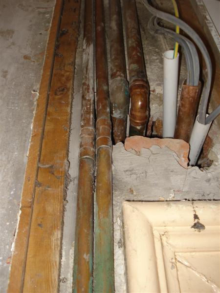

Picture of pipes near boiler and where they go upstairs and downstairs

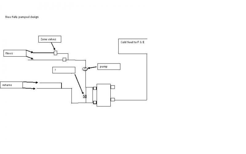

Here is a diagram that my plumber helped me with
On the righ t hand side it suggests that a cold feed is taken form the boiler to the f & e tank. So will this be a 22mm pipe at the base of the f &e where the old 15mm pipe was?
I take it I will still need an expansion pipe back into the F&E tank where will I tee this from?
