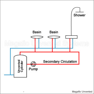

no that wiring controls when the cylinder needs to be heated and the secondary return circulator, moves the water in the cylinder around a completely different circuit for when you need to draw HW not heat the water in the cylinder, hence why you an only use a timer or PIR system, you can set a timer as already said for when HW is mostly used , if the timer is set to off you will still get HW from the tap but will take a while running to get hot, this pic shows how the secondary sytem works, it does not show the primary system (what heats the water in the cylinder ) only how the domestic HW is circulated from the cylinder around your home .

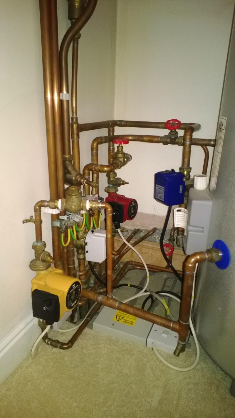

It would be a good idea if you posted a photo of the pump so we can confirm it is a secondary return pump.
If your primary pump controlled by your boiler you could probably just use the same live or use that live to switch a relay.
The yellow coloured pump is a Bronze pump, that is your secondary circulation pump

So is that a secondary return and pump and could it be wired in a way to come on when heat is called from the boiler, because others are saying no and use a PIR or Timer, thanks
No they are two completely seperate water systems, you can get wifi PIR sensors that all connect to a single on-off switch that will bring the pump on when someone enters a bathroom or kitchen, or a simple timer if you prefer, but you cant control it using your existing controls
