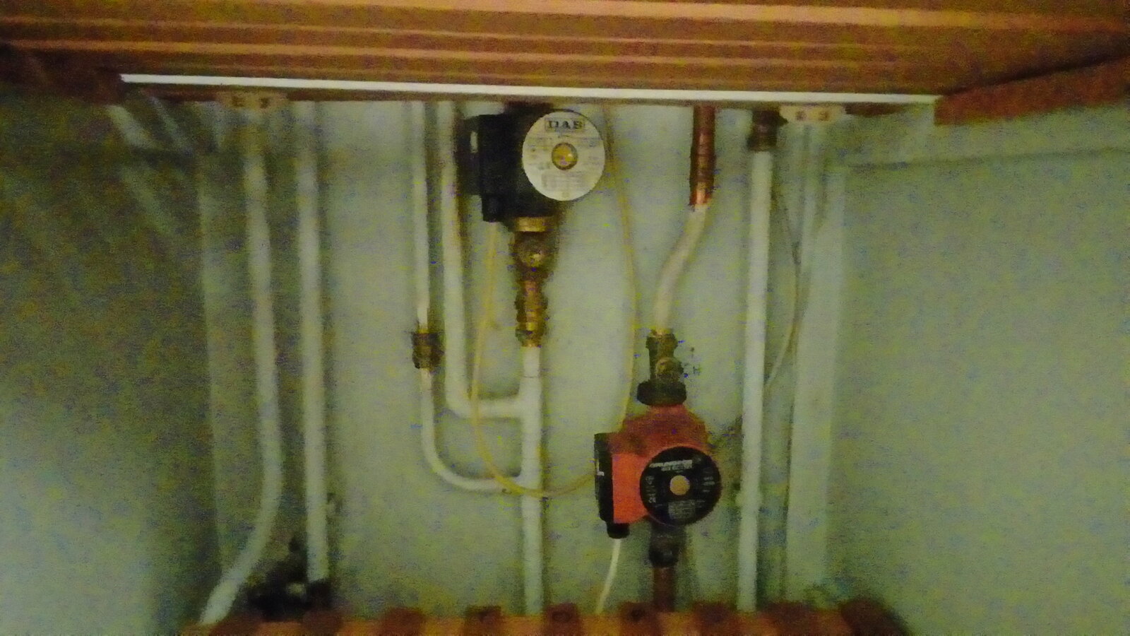

Hello
I have an unvented S plan system with two pumps one for CH and the other for HW the hot water one runs continuously 24/7 is there any way it can be wired to turn on just when the HW is called
Thank you
Ah ! I have this system, it's not as simple as people may think to have full independant timer control ofthe HW and CH. The problem comes in seperating out the ON signals to the boiler. So that CH "on" signal does not turn the HW pump on and vise versa because they get connected together at the boiler. One way is to have a motorised valve in each circuit and use the valve relay to turn on the boiler but the pump in each side is connected to its respective thermostat and not to the valve relay. An alternate method would be to have relays in the circuits to isolate HW from CH side if one of them needs to be off. I have a relay onthe CH side and a valve in the HW side because you need that anyway to control the HW temperature. We do get some convection flow through the CH pump that heats some radiators upstairs but thay have TRVs so not a problem. This is a very old system which was in the house and i keep meaning to have it replumbed to a conventional one pump system but never got round to it. Probably happen when the boiler gets changed. Here's a picture of the pumps. P_20201105_000923.jpg

Do you definitely have two primary circulating pumps, or is one a secondary DHW circulating pump?
That looks like a normal S plan. When the HW thermostat calls for heat, the boiler and pump in the diagram will run. The orange wires from the two valves run the boiler+pump combo.

If you ask the correct question , you will get the correct advice, what you posted was complete twaddle, you have an S plan with 1 circulating pump, and you have a DHW secondary return pump, absolutely not the same thing as you described, you can put the secondary return pump on a seperate timer, or use PIR sensors to turn it on when someone enters the bathroom or whatever
