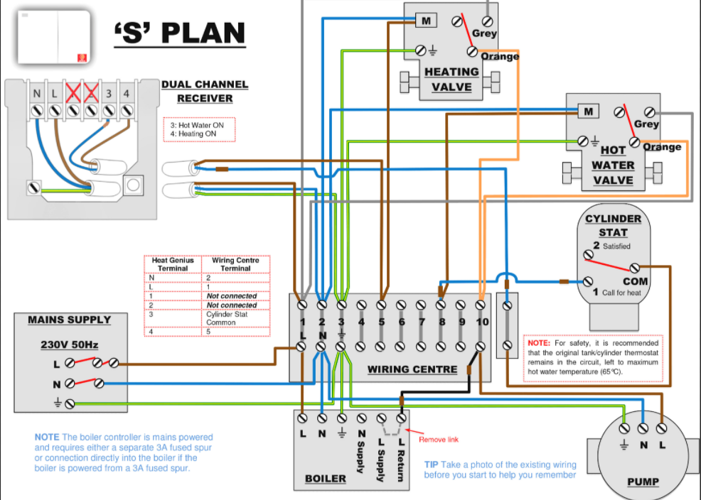

Personally I can't see why you cannot feed it from the H.W. on terminal of your programmer, but I'm not a sparkie. The boiler is controlled by a thermostat that feeds your zone valve, so there shouldn't be any backfeed issues.

No problem with controlling Bronze pump from H/W on connection before the cyl stat.
It wll run continuously during an on period without affecting stat, M/v Or boiler.

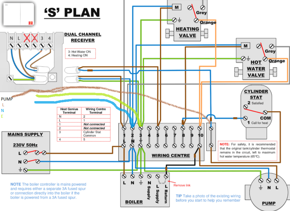

Excellent, that's great news which is actually what I wanted to do in the first place, could someone indicate where on this diagram I should connect it please, thanks

Ok so I now have my DHW Circulating pump or secondary return pump wired to Hot Water as @oilhead & @Terrywookfit suggested what a fantastic simple and easy solution everything is working as I originally wanted without the expense of PIR's & Time Clocks!
Thanks to all those who helped me understand and offered a simple Twaddle-less solution
