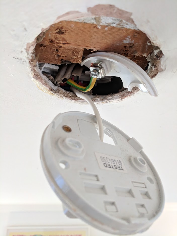

I have a ceiling light that I just took down. This is what it looks like underneath:
I don't really get what's going on here. Have they just not bothered removing the old rose so just left it in the void, broken in two, for the earth? And the new one just for the two wire feed.
The old light was metal but the earth wire didn't seem to go anywhere. I assume the new light (arriving today) will have an earth wire. Shouldn't it go to that earth wire in the broken rose?
And is all that rubbish safe to keep up there?
You need to get rid of the broken bits and re make all connections in a proper fashion into the new rose / light fitting. There looks like a loose wire that connects to the live terminal !!
No it is not safe, or correct. It looks like someone has used an old ceiling rose and stuffed it up into the ceiling void.
The connections should be inside an enclosure.
You need to (turn off the power first) and bring the cables down back into the room. Take a photo of what you are faced with before disconnecting anything. Remake the junction inside the new light fitting. If the light requires an earth then it must be earthed.

Thanks. I will take it all out. I have wago connectors that I assume will be good for tidying all that up?
Wagos are good, but the junction must either be inside an enclosure eg a Wagobox or inside the base of the light fitting itself.

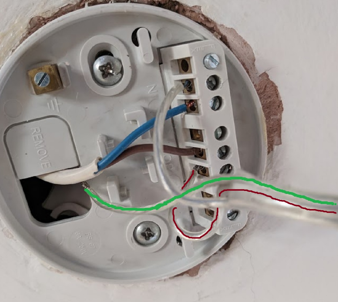

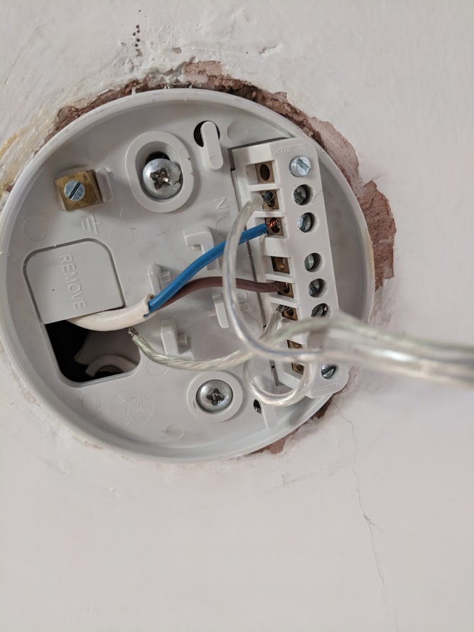

I agree rocky, I think terry has been tricked by the optical illusion. It looks to me like they go...
Otherwise the old lamp wouldn't have worked at all.
OP, show us the connections on the new lamp when you get it and how much space there is to play with inside its base.
This is correct. Just my crappy photo being a bit misleading.
All sorted now. I managed to get the broken rose out and there was actually quite a bit to play with. The light that's replacing it ( https://www.amazon.co.uk/gp/product/B01L99HC2Y/ ) has a slight void at the top that I thought about leaving all the Wago connectors in but I ended up putting them in a box (Wiska I think?) tucked up just above the light. Certainly better than how it was!
The light came with three wires each with a little choc-box equivalent attached but I just replaced the spaghetti mess with Wagos and removed the choc-boxes from the new light and wired them directly into the Wago connectors.
Hopefully that's ok?
