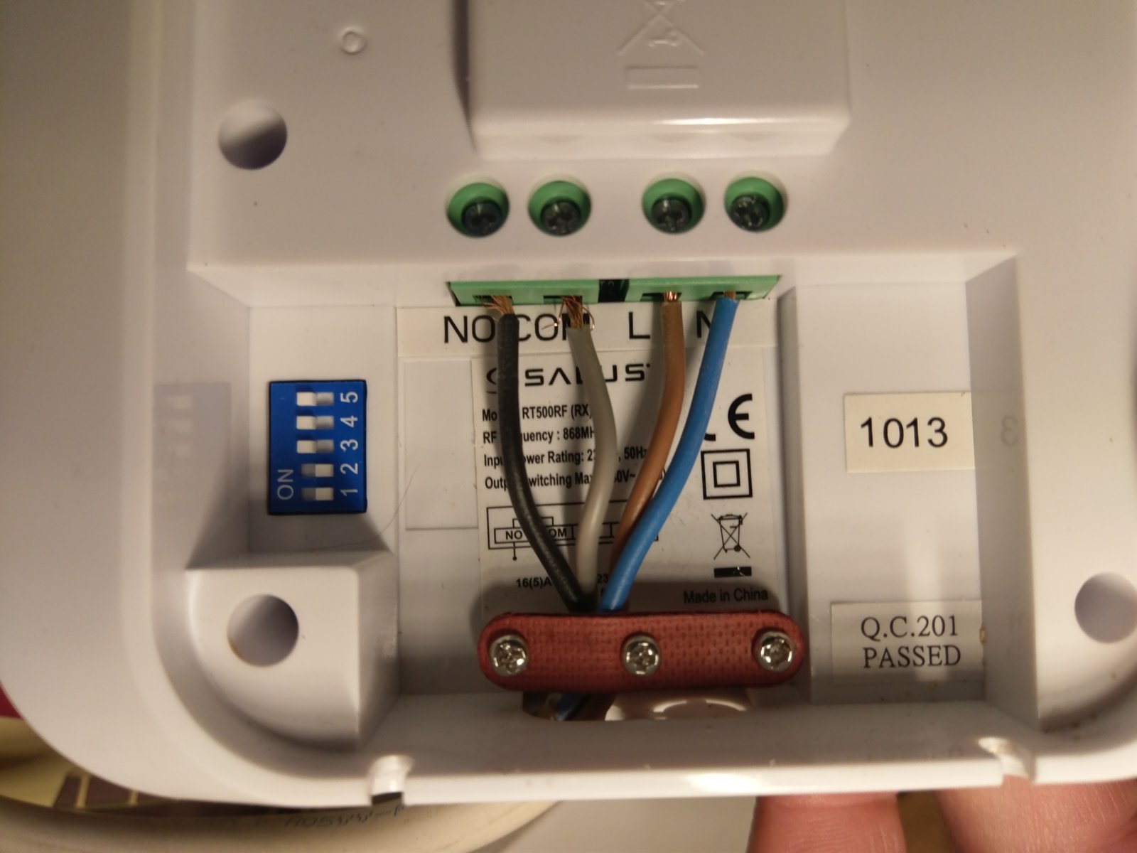

I currently have a Salus on my combi boiler and wanted to connect a hive connection
currently on the salus I have the following E921F3EE-2A99-4DB6-A2B5-0653D9325ED1.jpeg
could anyone advise where NO and COM would go?
thanks
Yes they go to NO and COM at the Hive, exactly the same.

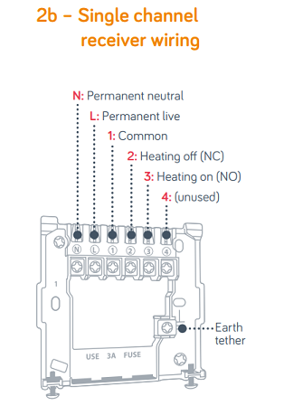

You should have the single channel version of the Hive, and you move the wires from the Salus terminals to the Hive receiver terminals that have exactly the same function. So:
Wire in Salus N goes to Hive (N)
Wire in Salus L goes to Hive (L)
Wire in Salus Com goes to Hive Common (1)
Wire in Salus NO goes to Hive NO (3)
