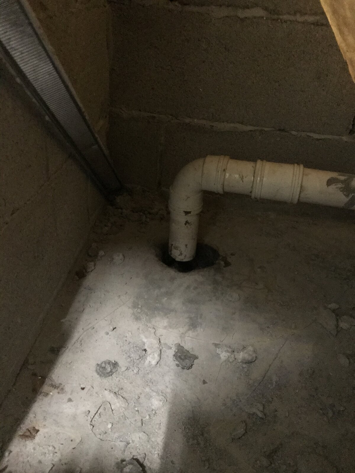

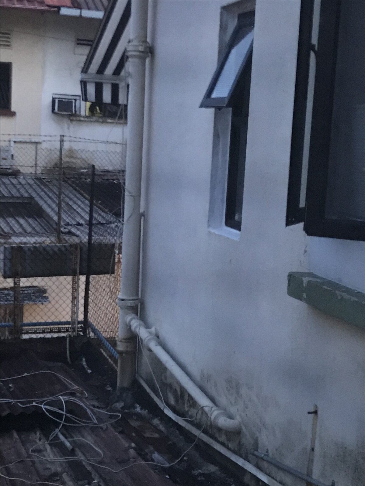

Hey guys,
I’m installing a saniflo macerating toilet, but having trouble finding a good spot to discharge the 22mm pipe to.
option 1- discharge right into where my current WC goes. The problem is i dont have access to neighbour underneath my house, so I would have to raise the WC or somehow cut a hole in my WC (after the trap) and attach a bulkhead fitting. Sounds risky
option 2- plug into the vent stack right outside my window (see photo attached)
option 3- discharge into the drain under my bathtub (see photo attached). Would it be an issue if there’s a P trap burried in cement slab ? How could I check that?
thanks in advance for any help, been scratching my head for days over this.

My Saniflo is plumbed in to my soil stack. I would assume that you could do the same with yours if other WC’s are going to it although why is that pipe running up towards your vent pipe? Surely the waste from the Saniflo would run down that if you joined above the connection for that pipe. Where does it go to or from?
My wc actually empties straight down, into a soil stack, hence i’m not sure how to best plug into it wirhout moving or raising my wc. As to the pipe going up to the vent, no idea what it is, but right behind the wall where it starts is my bathtub drain, could it be the vent for it?
