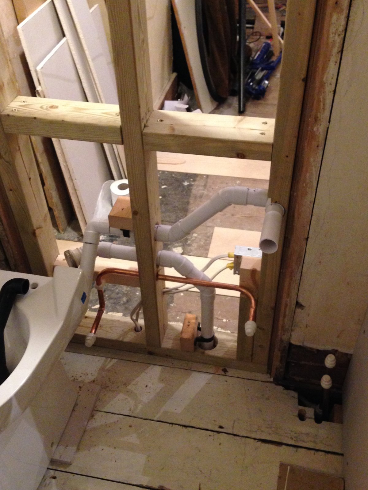

It is simple, you`ve got what 3 pipes to connect, 4 if you use the basin connection! You make made smile this end by giving up on trying to get a 32mm plastic pipe into a piece of rubber, what was the quote "It can`t be done, I`m giving up and taking it back!" :ROFLMAO::ROFLMAO::ROFLMAO:

Yeah the toys went out the pram.
I'm refurbing my house and anything that could go wrong, or be more stressful, has been this week.
It just seemed like much too small a hole, but obviously not so I've learned something new.
I do appreciate your time. Ta.
Didn`t realise you were doing up your own place for some reason I thought you were trade so sorry for some comments. :confused:

Reading threads on this forum I often wonder 'what happened next'. Well this is what happened next after a long day faffing about.
Tomorrow I'll insulate and plasterboard both sides before the spreads turn up on Wednesday.
A few pics.
