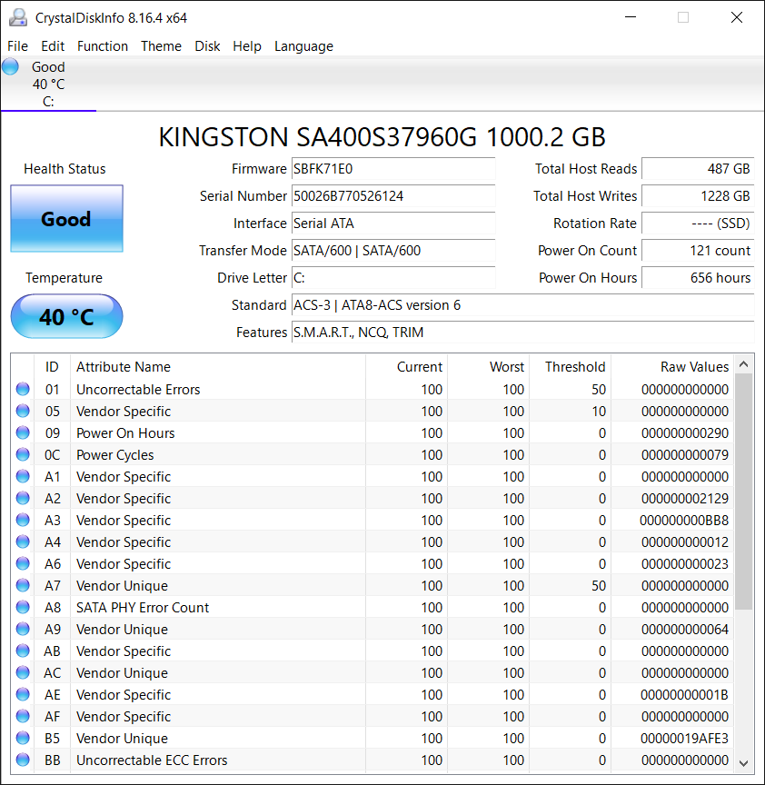

SATA SDD disappearing or corrupting often
Nothing in that image suggests any kind of error or problem. It's all 100% normal.

But the images does seem to show lots of errors? Are they meaningless errors? I will try a Memtest and leave it overnight tonight.
The image:
doesn't show any errors anywhere.
All the numbers are 100, which is their starting value. They reduce as various events occur, once they are below the threshold it will report via the BIOS or operating system as failed / end of life.
Images can be added directly to the thread, it's not necessary or desirable to use other image sites.

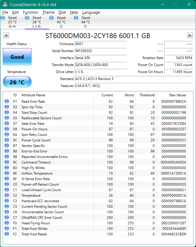

For comparison, this is what an older drive looks like, note that many of the values are less than 100 mostly due to age related factors. However none of them are anywhere near the threshold values, there is nothing wrong with this drive based on the information given.
Thanks for that clarification. I thought that the uncorrectable errors at 100 was a bad thing? But you seem to know more than I do!!

I ran CrystalDiskInfo again today and here is a PNG image of what came back. It does look like the Hard Drive is not right. Health and temperature are good but lots of errors listed below and the PC still crashing when asked to work a bit harder than normal, but still not very hard at all.
Assuming this issue is the disk drive and maybe someone here can confirm that when they see this image, is there any hope left for this drive? Even as an external drive? Or is it toast?
That drive has a 3 year warranty and free tech support. Perhaps you could contact Kingston and see what they recommend.
