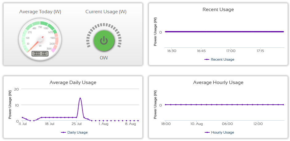

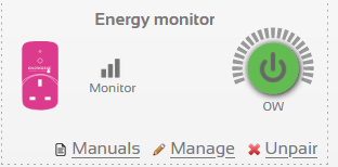

I did at one point start measuring how much stuff used, View attachment 276438or View attachment 276439 I can monitor what I use with each plug in appliance, but soon lost interest, I will use it to see when battery charger has finished, or if beer brewing OK, but why bother? With a few exceptions like seeing if freezer is working OK, knowing what it used does not help, we buy a washing machine which weighs the cloths, and auto adjusts the cycle time, and water used, so it never uses the same amount of power even with same program, so what is the point in measuring?

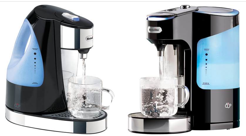

I've long thought that kettles should be properly insulated to stop them wasting heat, and you should be able to set the temperature, 90 degrees is plenty for tea and coffee.
So I had a look and I've had a Hubimex for a couple of years, which works really well...
I seem to remember the plumbed in water boiler did control temperature rather than point at which it makes steam, with baffles to stop the water mixing too fast, so cold water can replace the hot drawn without cooling the hot remaining.
