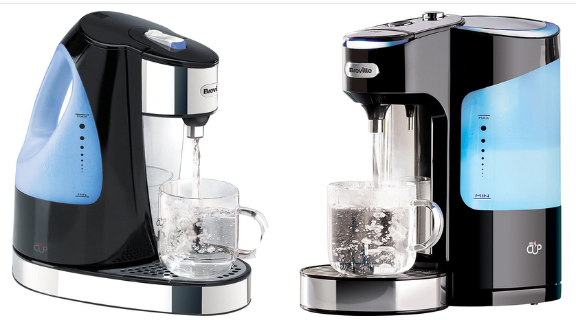

The idea of just putting enough water in the kettle does not really work, some one will some time forget and boil it dry, however the one cup kettle 1660147451754.pngdoes work, both same make, one on left fixed size, so need cups to match, one on right you can set cup size, and stop it mid flow, so one on right seems better, but although same wattage, the one on left always faster, the cup size is a bleed back into main reservoir, so always boils a large cup of water, even if only set to deliver small cup.

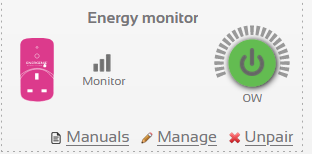

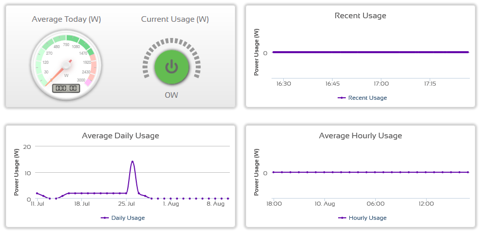

I did at one point start measuring how much stuff used, 1660148787025.pngor 1660148853836.png I can monitor what I use with each plug in appliance, but soon lost interest, I will use it to see when battery charger has finished, or if beer brewing OK, but why bother? With a few exceptions like seeing if freezer is working OK, knowing what it used does not help, we buy a washing machine which weighs the cloths, and auto adjusts the cycle time, and water used, so it never uses the same amount of power even with same program, so what is the point in measuring?

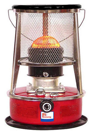

To conclude, there is no point buying labour saving devices, then using labour to decide when to use them. You don't buy a dog and bark yourself. I am sure I could get a oil heater and just heat one room in the winter, one of these 1660149851901.png placed in the fire place would heat the room I am sure, but unless I do some thing silly like have a heat pump fitted, I should never need to do that, back in the late 50's early 60's these were common, I hope we have moved on since then?
