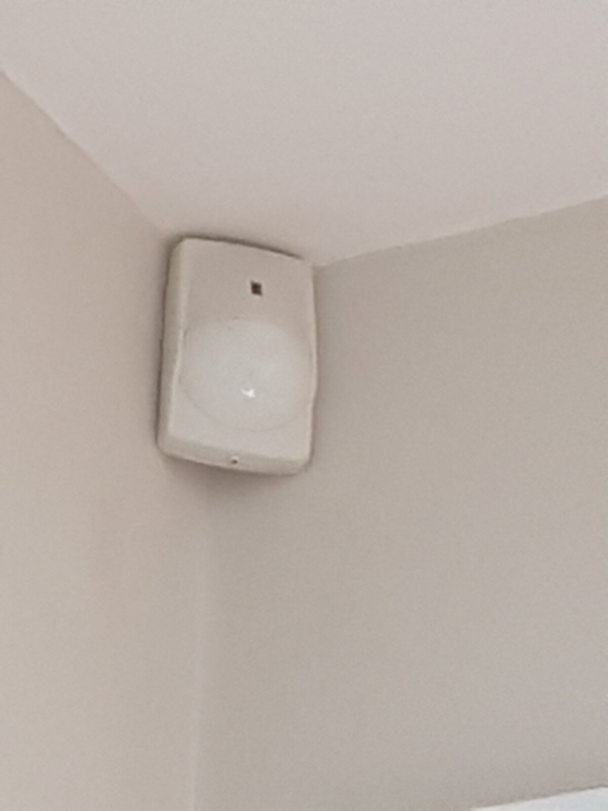

They are infra red sensors in the corner of rooms and the light still comes on if you walk past it
I have attached a pic just incase I have got it confused.

Well if pir lights up then the fuse is good.

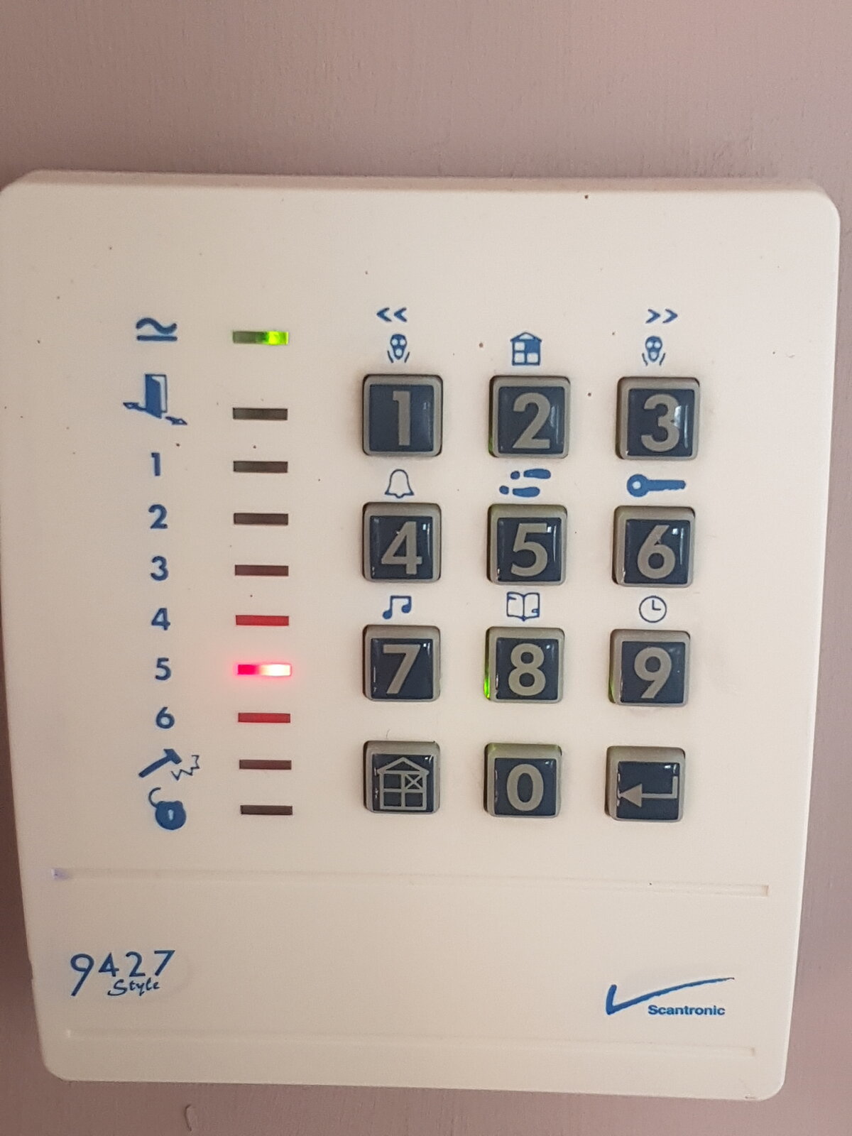

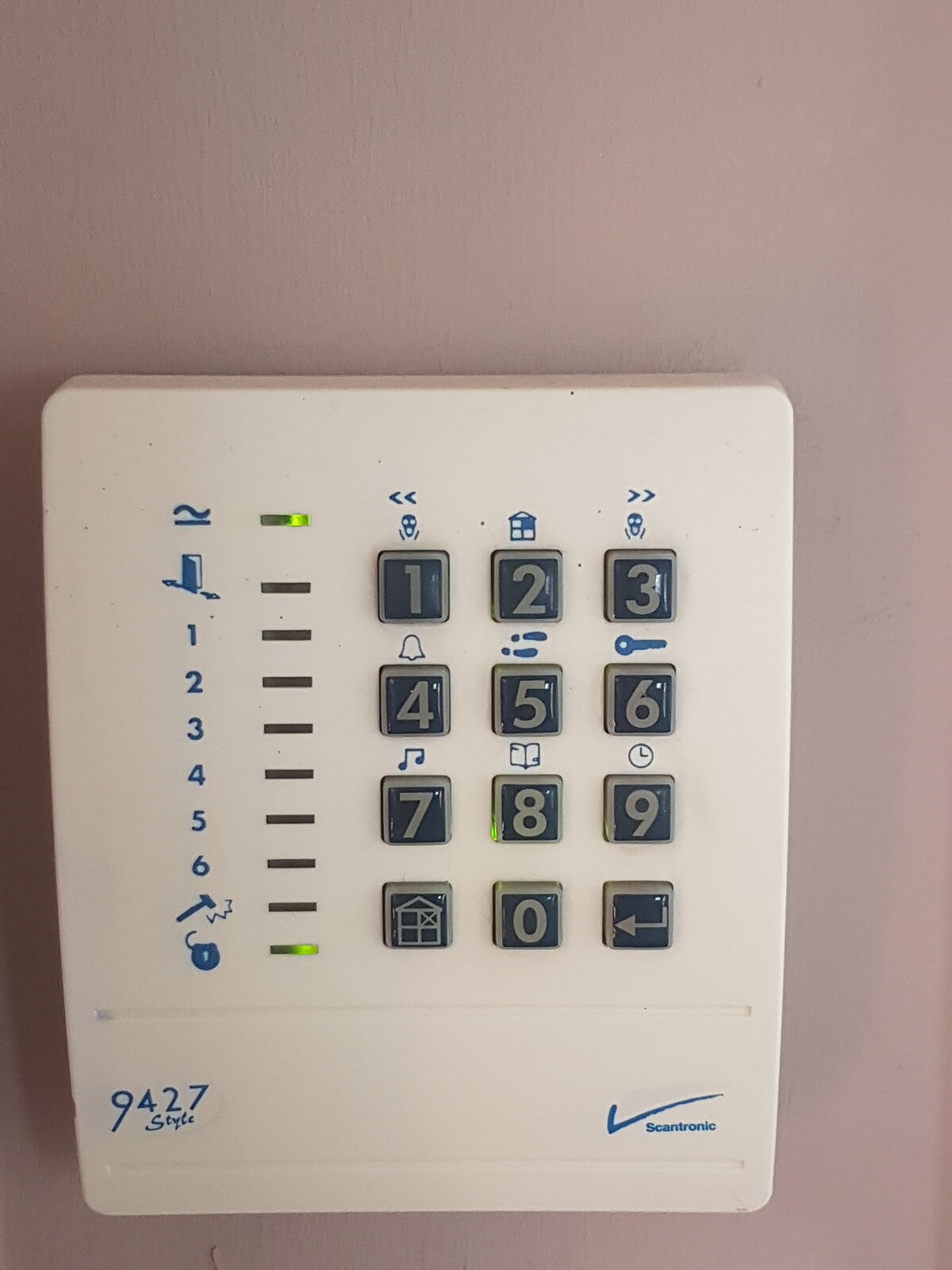

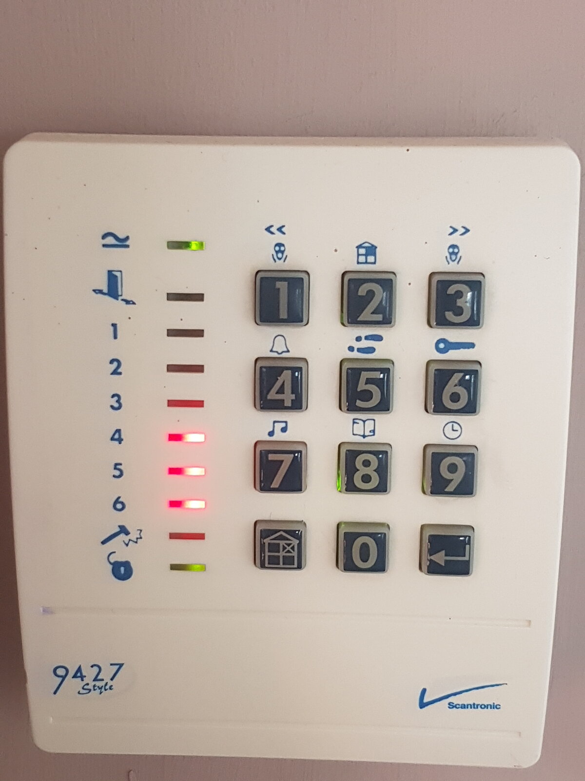

I have posted 3 pictures
One is the keypad in normal state with 2 green lights one top and one at bottom
The other has 1 red light that flashes between numbers 4 5 and 6 for 15 seconds once you press the keypad code to set alarm
And final pic is all 3 red zones lit up whilst the internal alarm sounds

They are probably unused zones and panel has defaulted back to used zones …..open up the panel and see if there are any wires in these zones …. If not either put in a link or program as not used !
Sorry what do you mean by put in a link?
I will try ommiting the zones and putting the alarm on and get back to you.
Ok looks like you were right and they are unused zones. When i omit them and put alarm on and trigger it in different rooms the zones are 1 2 and 3. So it looks like I can now set the alarm at night at least
Any idea how I get the panel to realise they are unused zones as default so ibdont have to specifically omit them every time?
0 enter ( or tick ) 7890 ….all lights flashing engineer mode ….15 enter , press 456 lights go out enter , 99 enter back to normal mode
