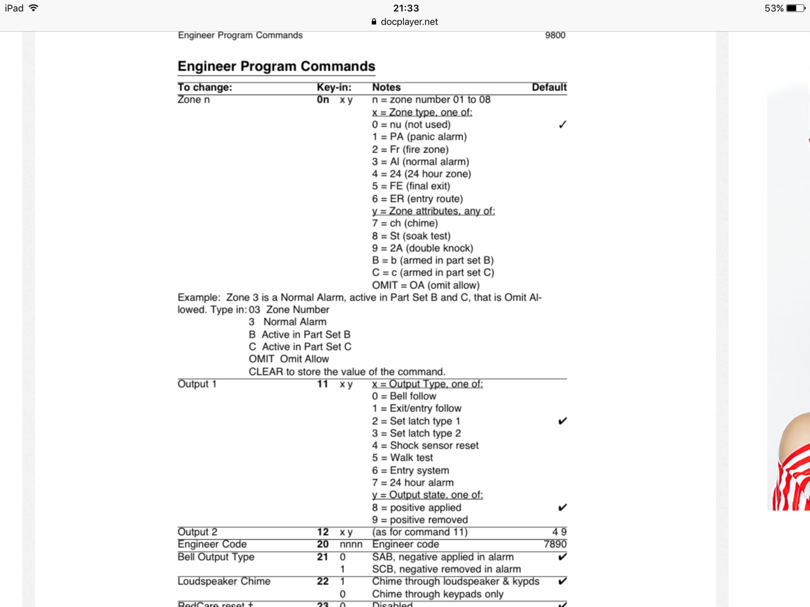

cAn anyone please help me I have just installed a new PCB board for my scantronic 9800plus alarm system and it’s back to factory settings nothing is programmed in its currently in E mode and when I push 01,02,03 and so on all it says is NU not used can someone please tell me how to programme my zones I only have 4 zones to programme Z1 is front door Z2 Hall Z3 lounge and Z4 kitchen thanks

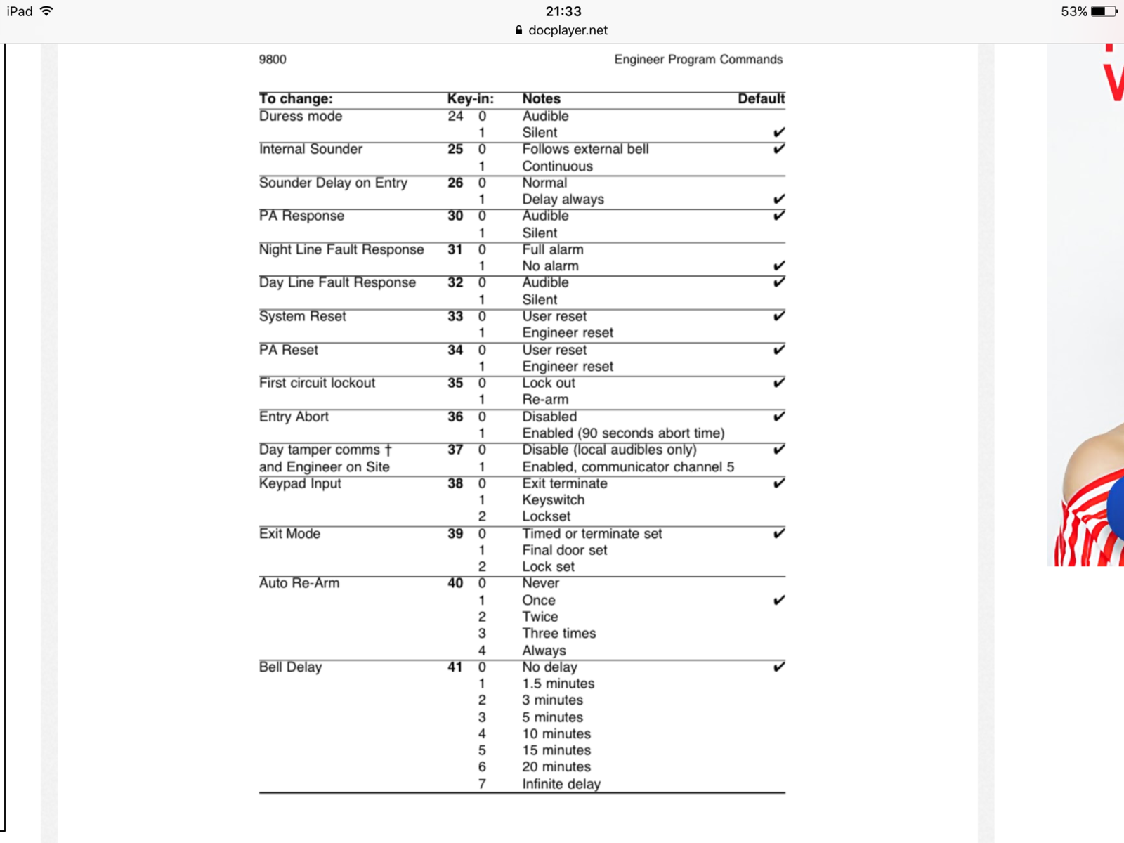

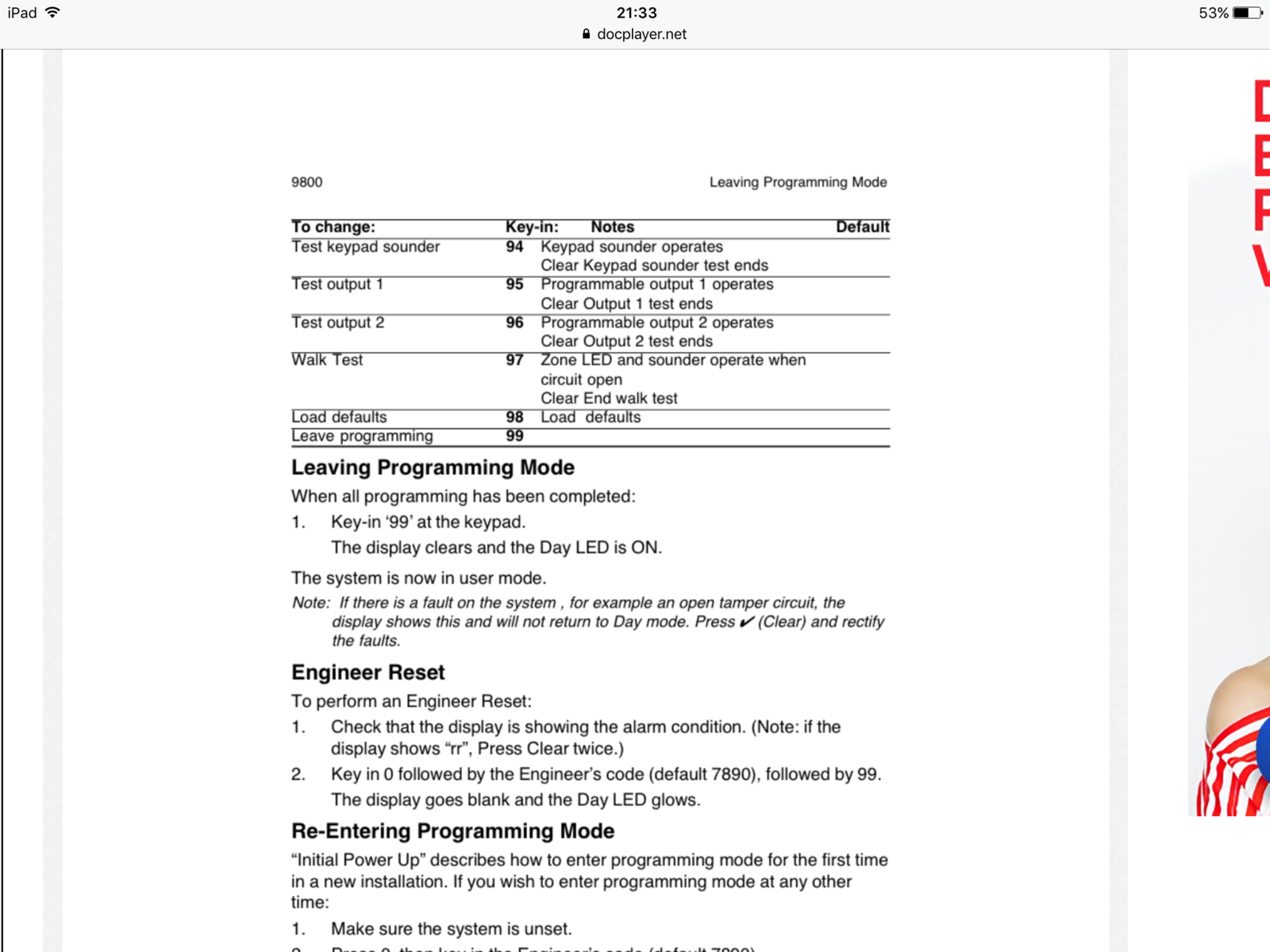

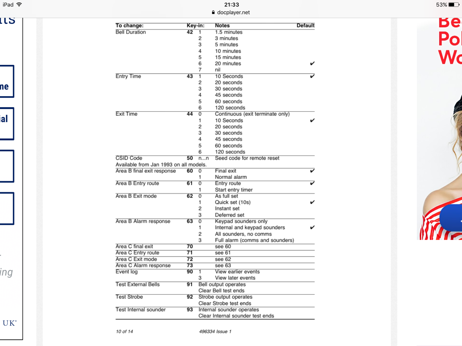

Example front door 01, 5 ,7, omit ,B, C
So zone 1 is ( 5) final exit , 7 it has chime , you can ( omit ) it and it's on in B and C
Hi thanks for reply it’s a town house and just downstairs is alarmed entry door is set of door contacts then in Hall is a sensor followed by sensor in loung and kitchen I have a manual but just can’t get how to change programme For exAmple zone 1 thanks

Just a quick update I think I have managed to programme zones I have done a walk test and all bleeps ok but I now have a T5 fault I can’t come out of engineer mode either and when I open front door I get T1 and T5
Sounds like you have the tamper pair on zone 1 mixed up with the alarm pair ... you may need to swop them around , and you have a tamper on zone 5 , put a link in the tamper terminal in the panel on zone 5 tamper ,
I am getting there I have disabled zone 5 and can now come out of E mode but now alarm goes off when I open front door with T1 fault thanks
