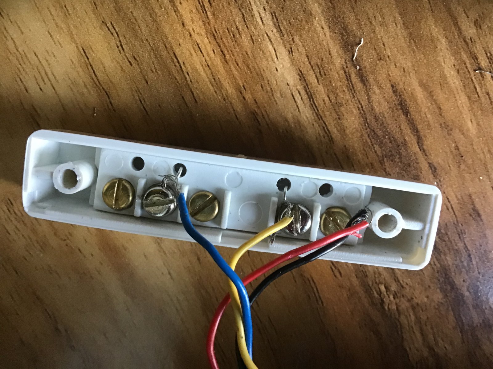

If correct the C1 pair goes on the two silver screws on contact
And he other pair are twisted together on one brass screw

Ok I have now put the blue and yellow wires on the silver screws and the red and black are now twisted together and on one brass screw I set the alarm waited for it to arm and when I open door the contact does not work the internal siren only goes off when first sensor picks me up then I disarm with my code I have done a walk test and door contact and sensors all work as they should something just don’t seem to be adding up thanks

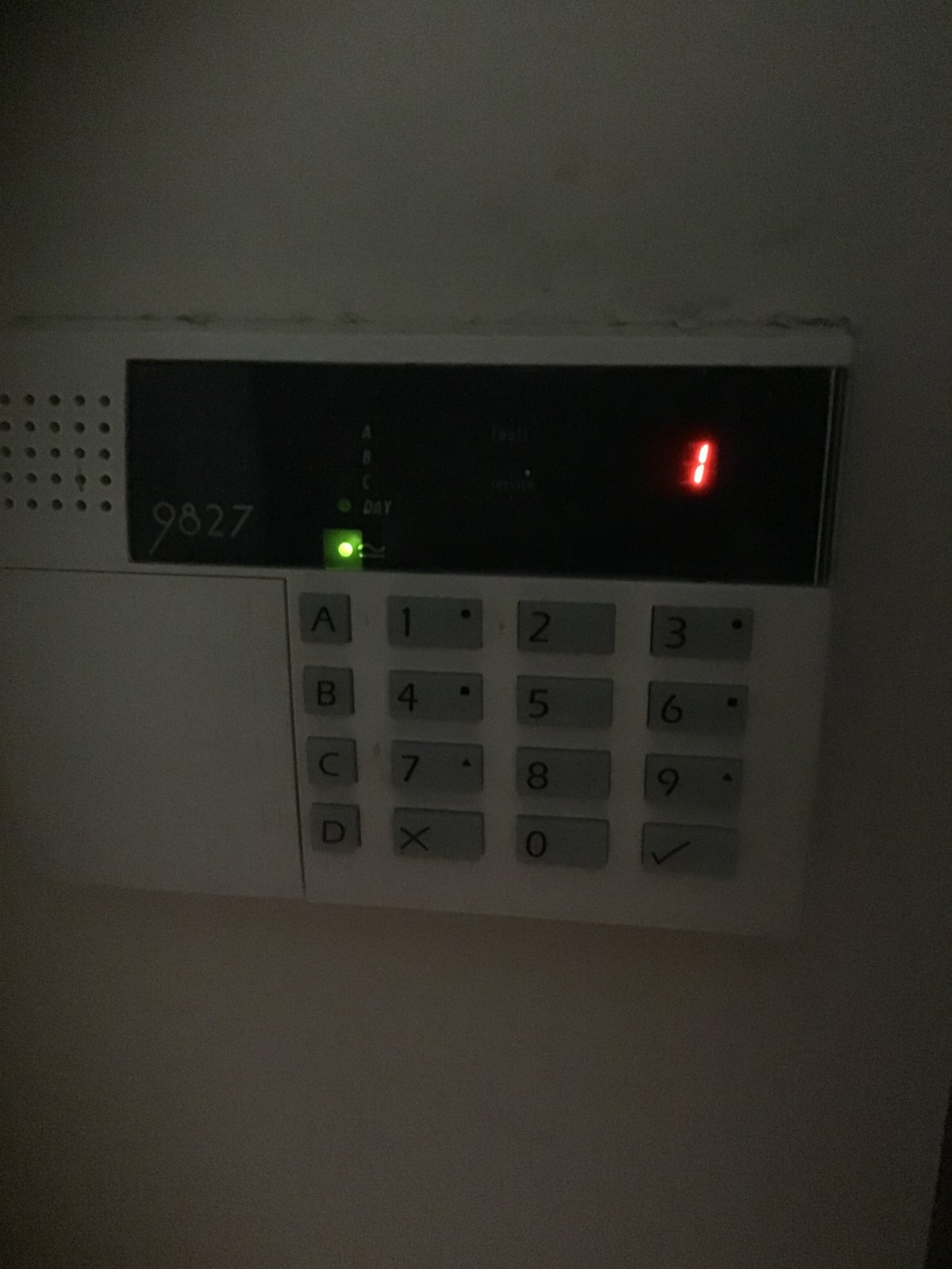

When red and black and blue and yellow are all twisted together I get — when blue and yellow or apart I get C1 and when black and red are apart I get T1 thanks
Blue and yellow are alarm pair they go on silver screws yellow on one and blue on the other
Twist red and black together and put on brass screw
That should now work

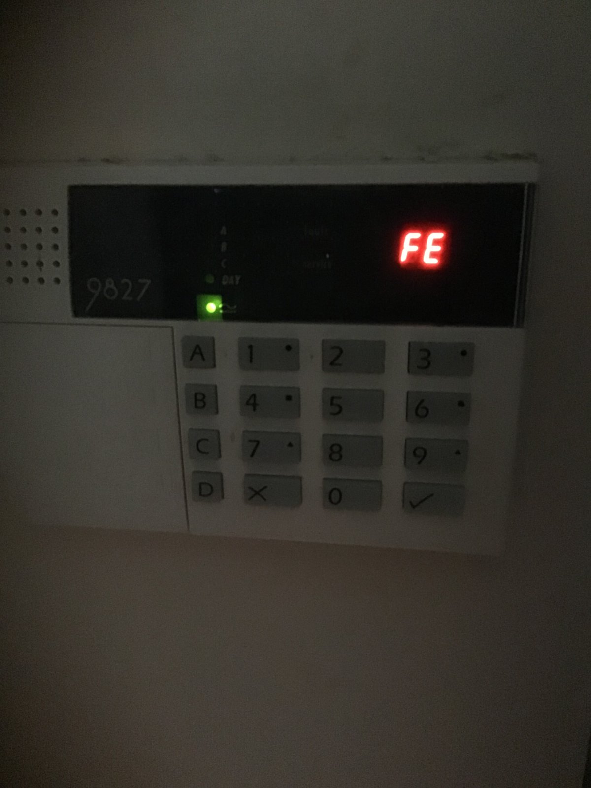

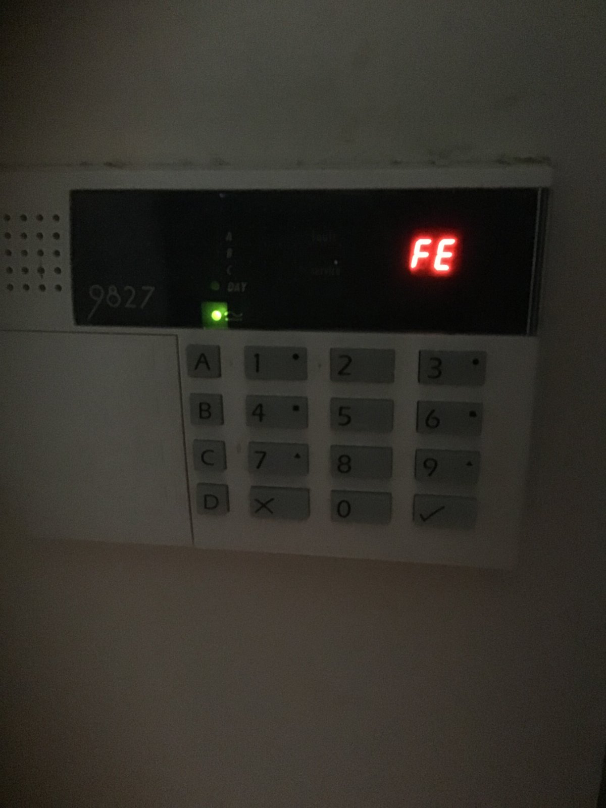

If not double check zone one programming should have FE selected

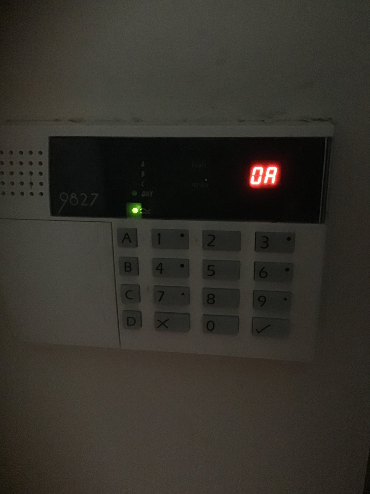

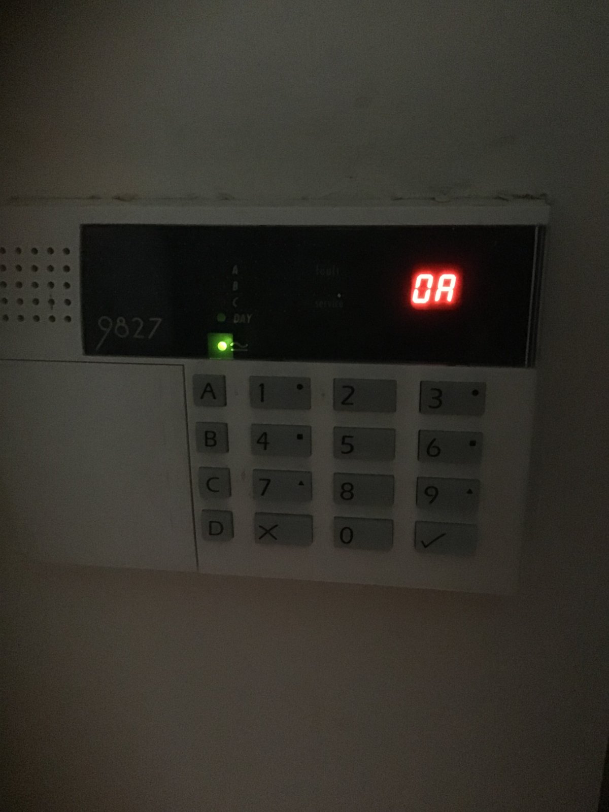

Ok I have done that and it does not work I went into E mode and pressed 01 and that says FE followed by 0A 1 I will send a photo thanks
Photos of zone 01 thanks

Remove the yellow and blue from the contact , twist the blue and yellow together ( cover up any detectors that see you at the door ) ok so far ....set alarm , break the yellow and blue wires , it should start the entry exit timer , if not .....touch them together again and open them again ( in case it's programmed for double knock ) not sure if you can on a 9800 entry zone ?
Ok I did that alarm continuous tone when it finished alarm was set I parted blue and yellow several times and nothing thanks
