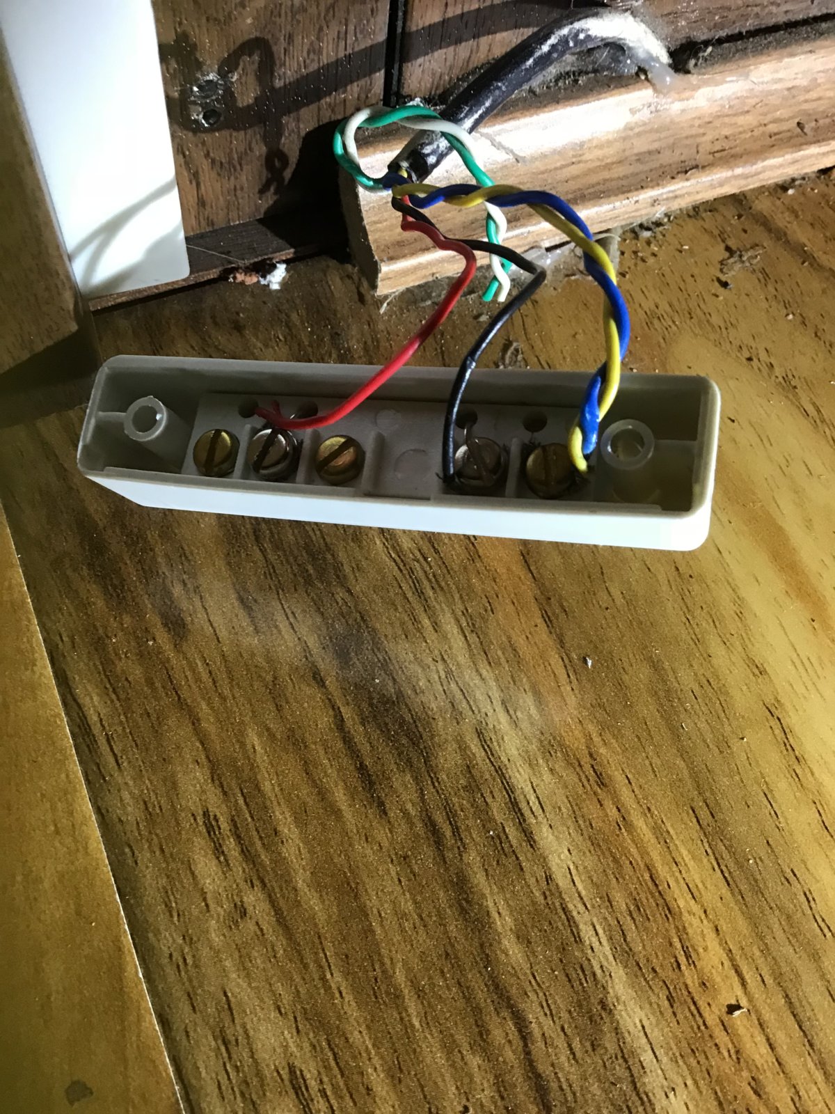

i have now got T1 on keypad I can come out of E mode but as soon as I open front door internal alarm sounds sensors do not set it off only the front door then I enter my code and T1 appears
Take the red and black out of the pcb for Tamper 1 and put wire like in .
Then try.
Ok i did that so now have come out of E mode I open front door nothing so now have set alarm and now alarm goes off when first sensor picks me up thanks
When I came in the house there was no sound once sensor picked me up internal sounder went off thanks
Also on programme zone 01 which is FE after keypad displays FE it then flashes 0A I don’t think I have any exit and entry times programmed but don’t know how to do this
You could have a faulty cable to front door ?
Can you take photo of door contact wiring.

Photo for door contact
Still think faulty cable / contact
Need to see wiring
Yes no no 1 this is a new contact
Told you to swop around the tamper pair and alarm pair ....you said alarm pair was blue and yellow ! It's wired red and black on the contact ...muppet ! Lol
