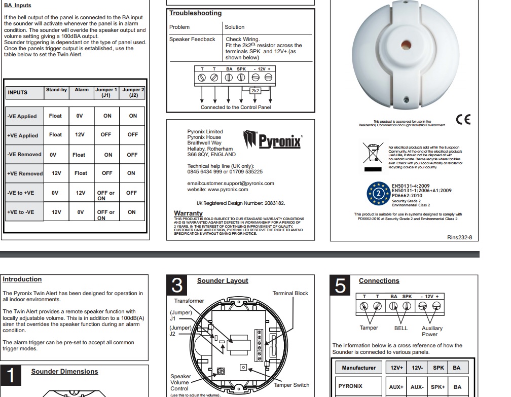

Twin Alert Details:
pyronix-twin-alert-jpg.136386
At the moment the + on the panel is connected to SPK on the twin alert, but the chime does not work, the Bell works fine. I've tried adjusting volume but no joy.
Any help?
Im sure i did when it was initally fitted, but will move it again and check. The bit that has thrown me is the + and - on the Alarm, 9752 etc all only had 1 connection for loudspeaker
Twin alert crackles whilst connecting to ls1+ however not beeping when connected to either + or -
