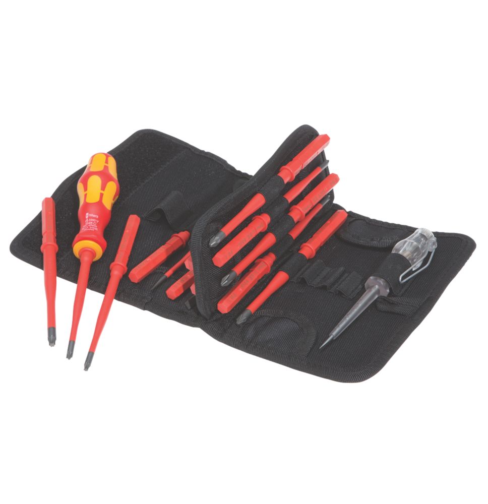

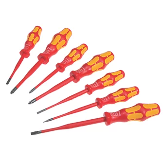

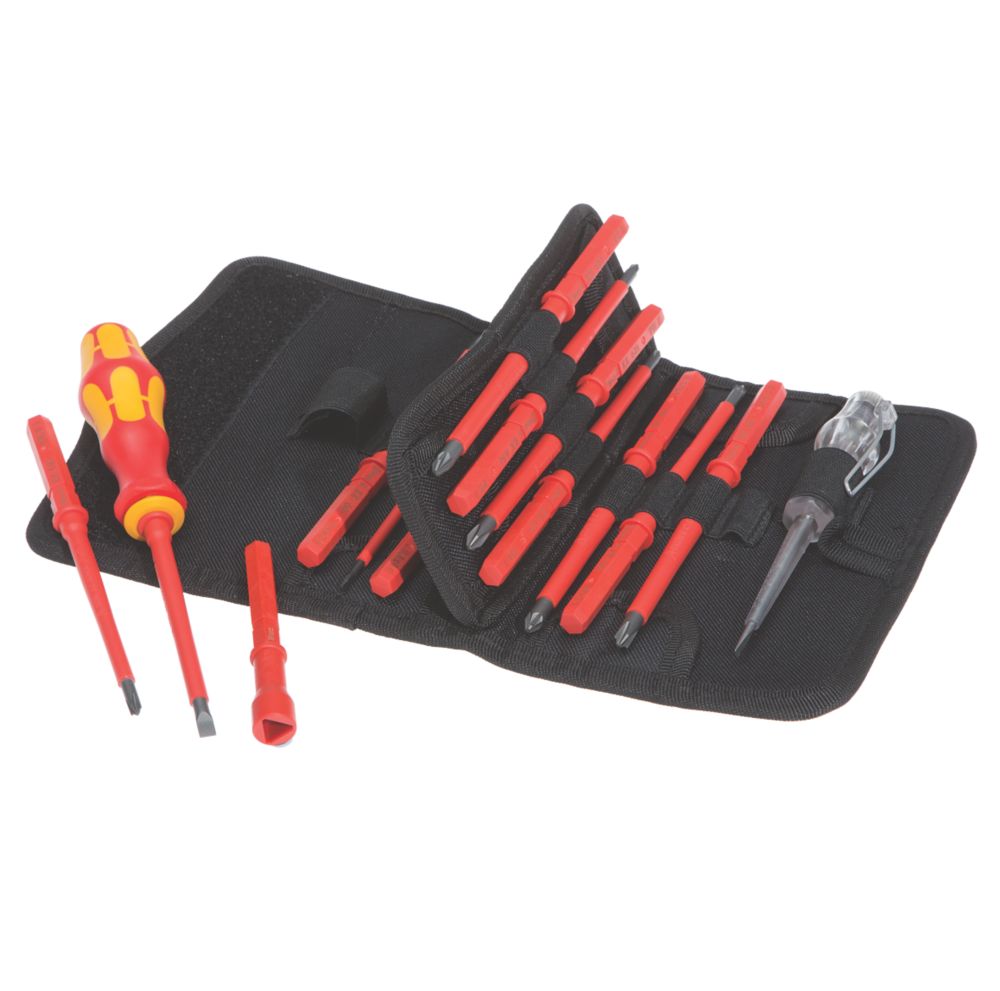

Was going to get a screwdriver set as part of a Christmas present for a second year electrical apprentice as they were talking about getting one, but I’m not sure which one to get. I know they wanted one that was insulated and a ratchet screwdriver, but I don’t know what the difference between these sets and was hoping someone could give some advice on which is likely to be more useful and which would be their choice, or is it a case of personal preference? I was hoping to get it without having to ask them as it’s a present, but I’ve no idea what I’m buying! Thanks for the advice!!

I have the one with one handle and the test screwdriver. Don't get that, I'd much rather have got the one with two handles.
Not sure you can get an insulated rachet, thats what the VDE mark is, I dont use them sets, but personally id have the first set with the two handles, it would be a pain keep swapping the shafts, you often need both a flat head and a pozi together. on a simple job.
One piece in the other sets the clear screwdriver is not much value really.
If you dont want to spend that much just get a 2 peice set of good quality MODULO screwdrivers, these are rarely included in sets but are the way forward in the trade.
Many like to pick there own tools though, i always use irazola they come in a set and are normal old school with handles , i again bin the clear screwdriver thats just there to cheaply bump up the sets quantity.

.... I dont use them sets, but personally id have the first set with the two handles, it would be a pain keep swapping the shafts, you often need both a flat head and a pozi together. on a simple job.
I have to say that for any purpose (not just electrical work) I find'detachable handles' a complete pain, which I try to avoid like the plague - it's not as if 'proper screwdrivers' (with handles!) take up all that much space, and I certainly don't personally regard the 'space saving' as going anywhere near compensating for the hassle ... but that's just me!

I have 1/4" hex drivers and a selection of bits for the unusual requirements but everyday screwdrivers are not detachable blades, no way, no how. Horrible wobbly things with rotational slack. I know we all say a bad workman blames his tools but it's so much better when tools work properly.

Thanks for the advice. I was only looking at these ones as he had used someone else’s and said he liked them, and was looking at them online to get his own set as he’d lost his insulated screwdriver at work, but didn’t get them due to the price, but not sure what one he was looking at. Any other recommendations gratefully received though!
Personally I would go for individual insulated screwdrivers or perhaps a set of.
I do not like the interchangeable bit thingys - I suppose if you had two handles rather than just one then it is an improvement.
One thing I would advise considering though is the torque screwdriver and that would come with interchangeable bitsbut they are not cheap so it could be another present for another day perhaps.
Ideally a few slotted, a few phillips and a few pozi (note - Pozi and Phillips are not the same), that would be your "starter for ten" as Bamber used to say.
You would need say 3 sizes of each so at least 6 , better still 9 .

PS - don`t let me put you off the interchasngeable sets you have shown, if you are prepared to change blades (which is the bit I do not like about them) then yes they all look pretty good to me.
As said , bin the clear one.

Ihave the wera wiha and klein, all slimline, one set for ph pz and slotted, makes identification easier in the tote.

For an apprentice I'd not buy a set of interchangeable bits/blades. Much to easy for individual items to get lost or borrowed and not returned especially as an apprentice. I only have one tool left from my apprentice days, the metal box.
In My Humble Opinion a set of 'Fixed blade' VDE screwdrivers from Aldi or Screwfix/Toolstation along with a Cabinet Pattern Srewdriver set (e.g. Draper 14078) will be better idea.

Thanks for that, will have a look. He has to supply his own tools but from what I can gather they need to be insulated ones.
I personally dislike that handle shape, as silly as it sounds they simply don't fit my hands. Others I work with love the shape.
Something that many don't consider is a smaller screwdriver usually requires a thinner handle, example:
A handle designed for a No2 Posi or 8mm flat blade is too cumbersome for a 1/8" flat blade when wiring a 13A plug.
I find I regularly have several different screwdrivers in use (commonly 3mm, 4mm, PZ1, PZ2, PH1, PH2 is very typical) and constantly changing bits would be a real chore ie position wire to hold in place while fixing, release it to change bit to 3mm flat, re-position and tighten, position other end, release it to change bit to PZ1, re-position and tighten etc as opposed to; position, select driver and tighten, position other end, select driver and tighten. Followed by change bit to PH2 to mount device.
