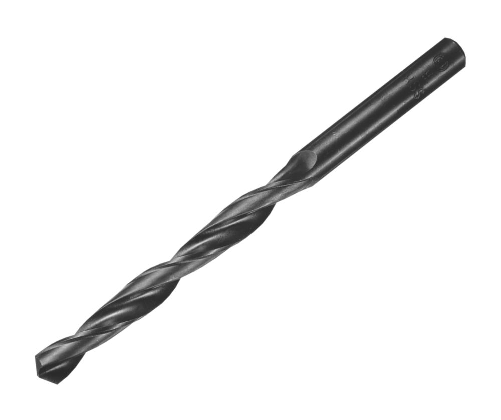

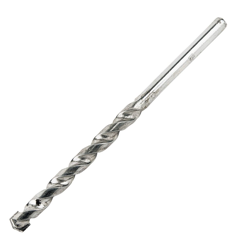

I had difficulty to drill the wall.
please post a photo of the tip of the drill (bit) you were using.
It should look like this
ae235
Not like this
ae235
Does your electric drill have hammer action?
I would like to say a big thank you to Cawhaley, your answers are very helpful. Also thank London Mike 49 and JohnD. I think I need to buy a good drill bit, drill itself is from Lidl which should not make differnce, but bit does.
Holes too shallow , should be easy to drill so drill or bits need replacing.
