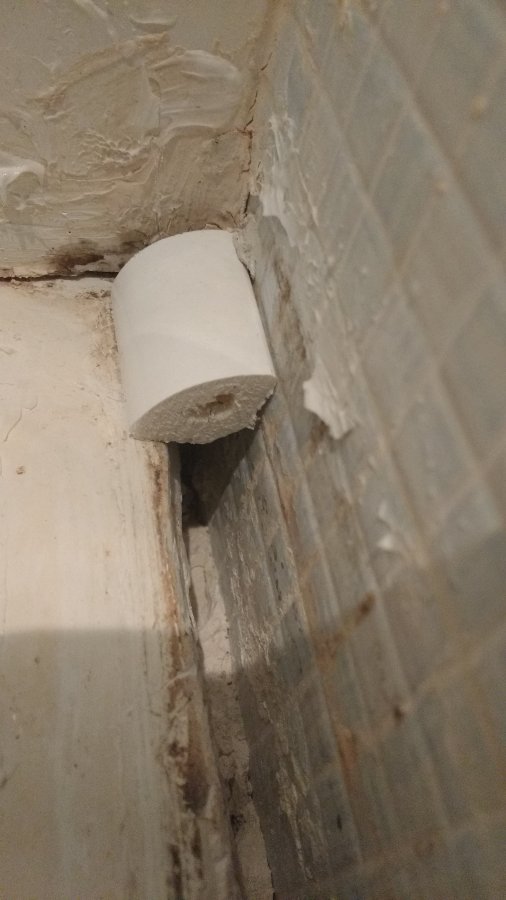

There is a gap between my shower tray and wall as shown in the picture in the previous post. I have bought window trim which I shall use to protect the gap which I will seal with silicone.
What I'm unsure about us what to fill the gap below the window trim with if anyone has any ideas?
As we've opted for the bodge it option, how about foam fiiler or an off cut of wood followed by sealant, then the quadrant?
Should work, pump the gap full of silicone and bed the trim in, then silicone the edges, but you need to get both the tiles and the tray really clean to get good adhesion with the silicone.
