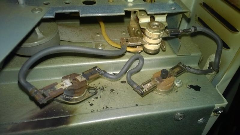

Picture one is of the two cutout assemblies ... the left one is the faulty (blown up) one.

All other parts tested ok. The fault was it blew the main fuse - Hager cartridge fuse BS1361 consumer unit - a bit unusual to have this in a domestic environment, although have seen it before a few times.

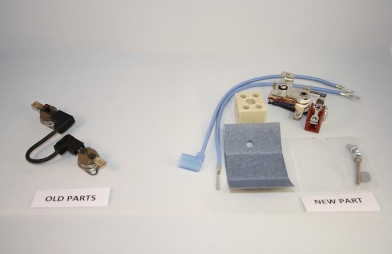

The replacement for the two separate cutouts looks like this: http://www.storageheater.co.uk/dimpex/xl-xt/xls/xls24/charge-limiter-cutout.html
there are several variations depending on the model of heater.
Installation involves removing both the old disc cutouts and the regulator, the new item replaces the whole lot in a single assembly.

Thanks for update Flameport ... I looked at that one online too, I am a little unsure what it replaces though. Not sure if you can see from my picture what looks like the Thermostat assembly. Would this just connect across that unit ?
The replacement unit is everything in your picture, including the thermostat that the knob fits onto. Hence getting thwe exact one is vital, otherwise the thermostat spindle won't be in the right place.
If the customer has another heater of this type, a far easier fix is to see what the rating of the blown cutout is, and just buy one of those.
Spoke to the guy from the website and he said the model number needs part number 9509007 ... so ...
ordered this part (on the right) to replace the two that had been installed previously (on the left) still not cheap! with postage and VAT still comes in at £38 ... Landlord is paying so not my issue.
