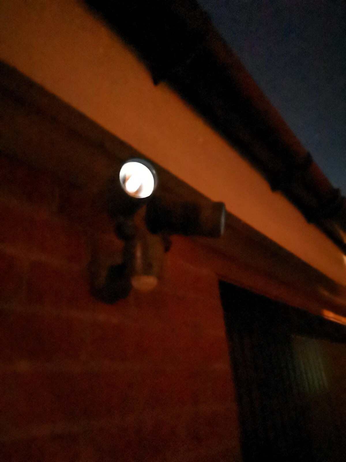

Hi I've a 6 year old b&q licina blooma security light which was using halogen bulbs.
I bought some G9 bulbs hoping to replace the old halogen bulbs and went for these
https://www.amazon.co.uk/dp/B07F1P81GZ/ref=cm_sw_r_cp_apa_fabt1_frdVFbFFJZSWQ?_encoding=UTF8&psc=1
Hoping they would brighten up the driveway but after putting them in the bulbs are on but very dim to the point there doing nothing.
I thought maybe they were knackered or dud took 1 of the bulbs out and put the halogen one back in and boom the other side now comes on. If I take the halogen one out the light goes dim again
Any ideas?
The light says 70w max the G9 bulbs are 6W =60W is that the problem?
Is there a PIR on the fitting?
Edit.
There is, so it would appear the new LED lamps are too low a load for the PIR to switch.
When you replace one halogen lamp, that boosts the load and the LED illuminates fully.

Bugger so means I can't use leds to save money?
Some security lights like yours require a load of an old bulb to work. Annoying.

I bought 2 solar lights to replace the 2 b&q lights last month but can't use 1 of them where the one in the pic is as it doesn't get the sun,and I've backtracked a little as I'm thinking mains will always work would just be nice if they were low energy.
Sometimes you can bypass the sensor on your existing light, fit your led lamps and mount a seperate sensor.
Sometimes if it has a big base you can mount the sensor on that, old Halogen pirs are cheap nowadays and often the pir will screw off and you can fit that.
Tbh the pir isn't great on the current light you can walk halfway up the drive before it switches on.
