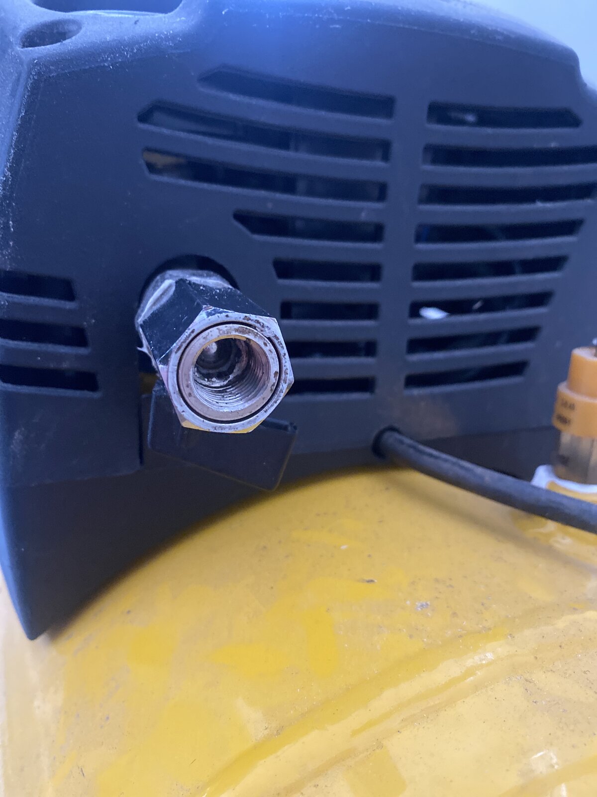

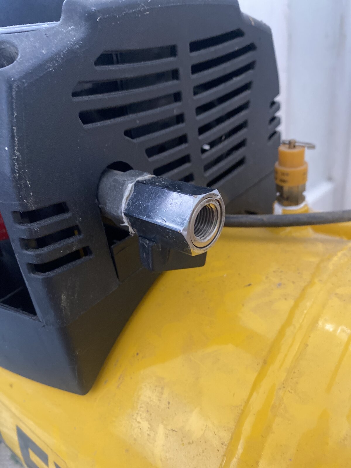

Hi.. I’ve just bought an air compressor on eBay and the connections aren’t as I expected.. I’ve been onto screwfix and completely confused myself now with sizes and what not…. I’ve put a picture of the connection on the compressor. Could anyone offer any guidance with what I need to get just to get me started please.

Duncan, I think you’ll need a 1/4” male quick release air line outlet fitting for this, or possibly 1/2” male.

John it's not a quick release, it has an internal thread, probably a pipe thread. That is usually where the pressure switch fits, the gauge, and a pressure reducing valve, then finally a quick release socket. I think I can see a pressure safety valve, extreme right of the second photo. A photo from further back, wider shot might help.
you need a female quick release air fitting with a BSP male end on it (it’s probably 1/4” but could be 3/8” or 1/2” - bear in mind that’s not the diameter of the thread)
There are quite a few different quick release fitting types but the most common are Euro and PCL.
just to confuse things quick release are available in double and single release - single is fine for most applications, but they do come apart if you stand on them.

Notch has pictured what I meant Harry - I just didn't explain it too well!
