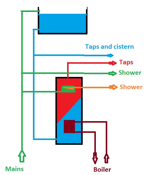

The problems with many of these on the market, was that the shower coil was always too small with the temperature needing to be too high
Mine was custom built so I specified the size of the shower coil. But made it too big which reduced the volume of water in the cylinder. But it works and does two long showers with ease before the temperature in the cylinder drops too far.
A hot water cylinder fed via CWSC wouldn't utilise a mains fed coil..:)
It does have a mains fed coil for the mains pressure hot feed to the shower. It is part thermal store ( to heat the mains pressure coil ) and part hot water cylinder fed via CWSC
What does?..what unit are you referring too.
So the stored water temperature within 'cylinder' is around 80c in order to heat mains coil?..and you're also saying another tapping is used to feed hot water draw offs?
Enlighten me.
Hey Bernard , this must be one fook off sized unit in order to enable surface area of HW mains fed coil along with volume of water for gravity fed HW outlets.
Unless you're referring to what's known as a 'sidewinder' which was an add on and not supplied/recommended by any cylinder manufacturer.
These were also absoloute pants when fitted due to surface area of coil , also the cylinder was susceptible to scale due to high store temps.
