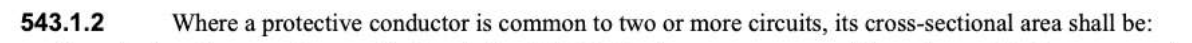

In view of:
the answer to the question must be "No".

In view of:
Indeed. That reg seems to be essentially saying the same as I have been writing.
However, I would agree with others that whether or not it is a 'desirable practice' is perhaps more questionable since (a) putting multiple eggs in one basket is rarely a brilliant idea, and (b) although we should perhaps not have to consider it, subsequent 'unthinking' changes to the installation could undermine the situation.
Of course it is.
Yet the answer to the question is still "No".
