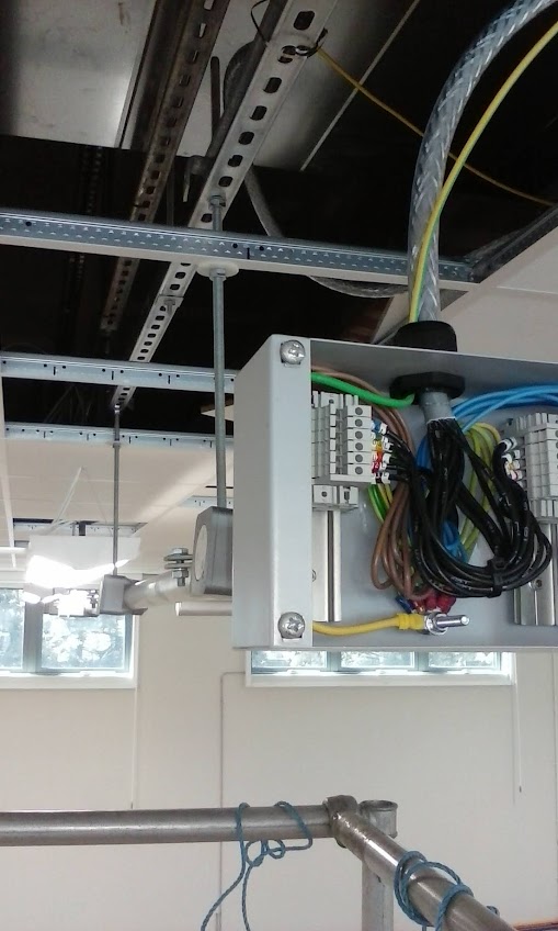

Nice to see it's not just me who can't get DIN rail terminals to sit straight.
depends on the terminal make, that particular job I had far too little time to install the bars and wire them so straight terminals was way down on my list of priorities :(
Well I will admit it`s sometimes easy to get the MCBs slightly out from slanted a tadd on some makes. So same thing really to a lesser degree :unsure:
Oh oops - didn't think about it might be your work.

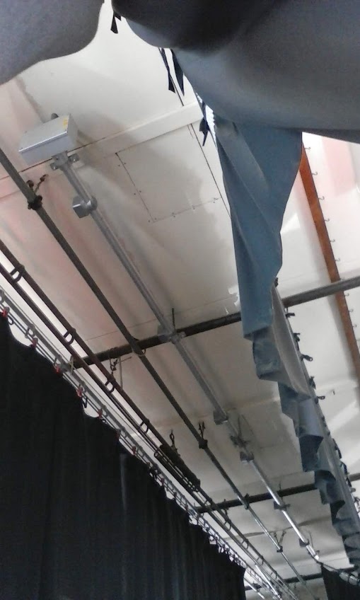

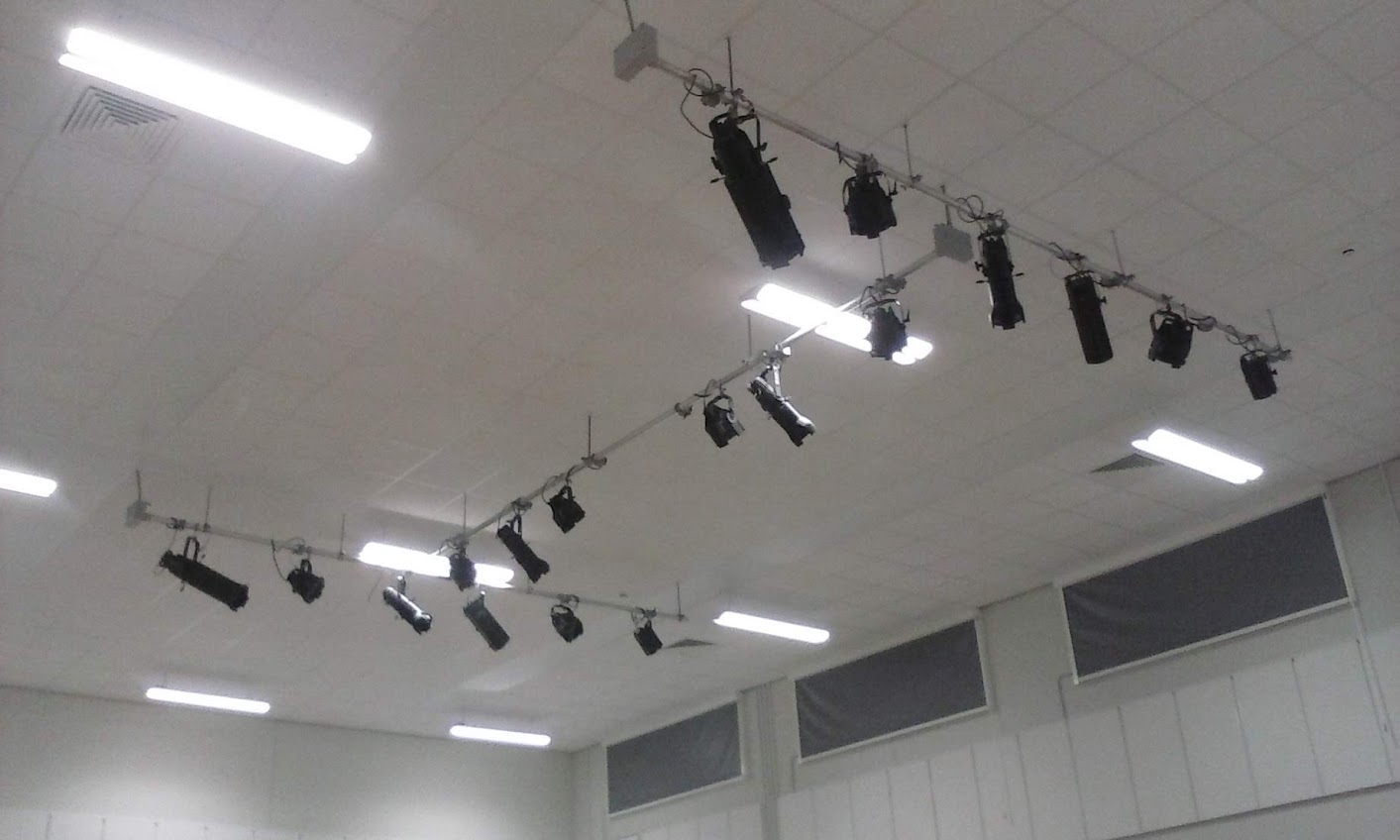

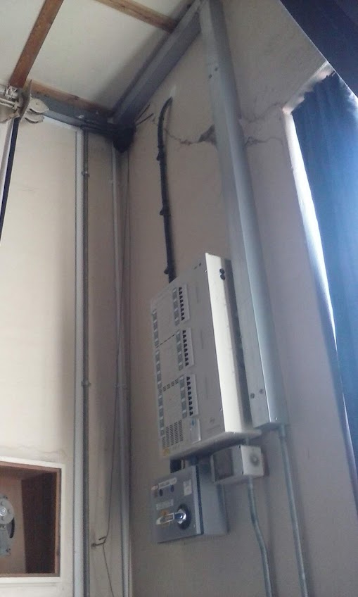

The history of those internally wired stage lighting bars and dimmer: I installed them in 2007 in a school, Approx 80 hours including all of the conduit cutting/threading/bending, metal work in the restricted ceiling void
steel trunking and dimmer etc
then in 2017: working round school use of the hall including working quietly behind the stage curtains during PE & drama classes etc, in a great hurry had less than a day to strip them out and shift it all to the new building.
Then re-install in 3 days

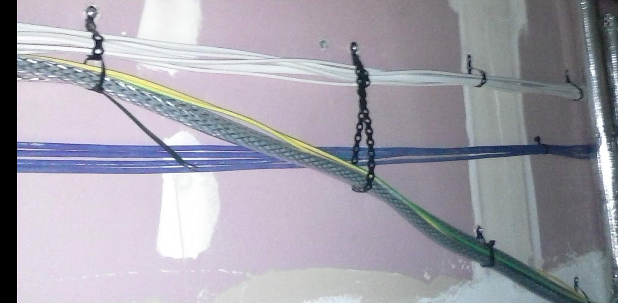

The builders installed and weight certified the Unistrut and ran the SY/earth
Yeah nice install!
leaving me ½ day to hang and focus the PATd lights and fully commission,
with the builders seemingly taking the scaff tower down as I climbed down, or so it felt.
About 40 hours including assistance removing the lights on the first day and on the last to rehang them and commission.
Normally I'd try to make theterminals tidy but chances are they were dislodged when decommissioning and re-installing but the last thing on my mind was: "Are the terminals straight? when the builders are locking up halfway through each day. As least I got a free mug when my delivery of studding, nuts, washers etc arrived; Cheers

I was in the team for the initial installation of this:
14* 4mm² singles in a 32mm conduit at a height of 6m, that's R,Y,Blu,3Blk,Gn/Y*2 for each tube. Effectively 3 circuits, each fed by individual contactor but only 1 earth, then repeated to make 6 circuits per tube. 2 tubes per row

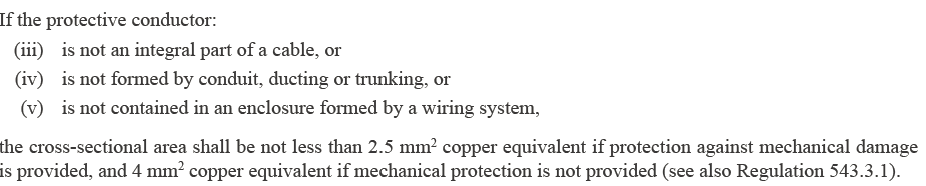

Does 543.1.1 not require any standalone 'protective conductor' (which I presume includes a SB conductor) to have a CSA of at least 4mm² unless it is 'mechanically protected'? ....
