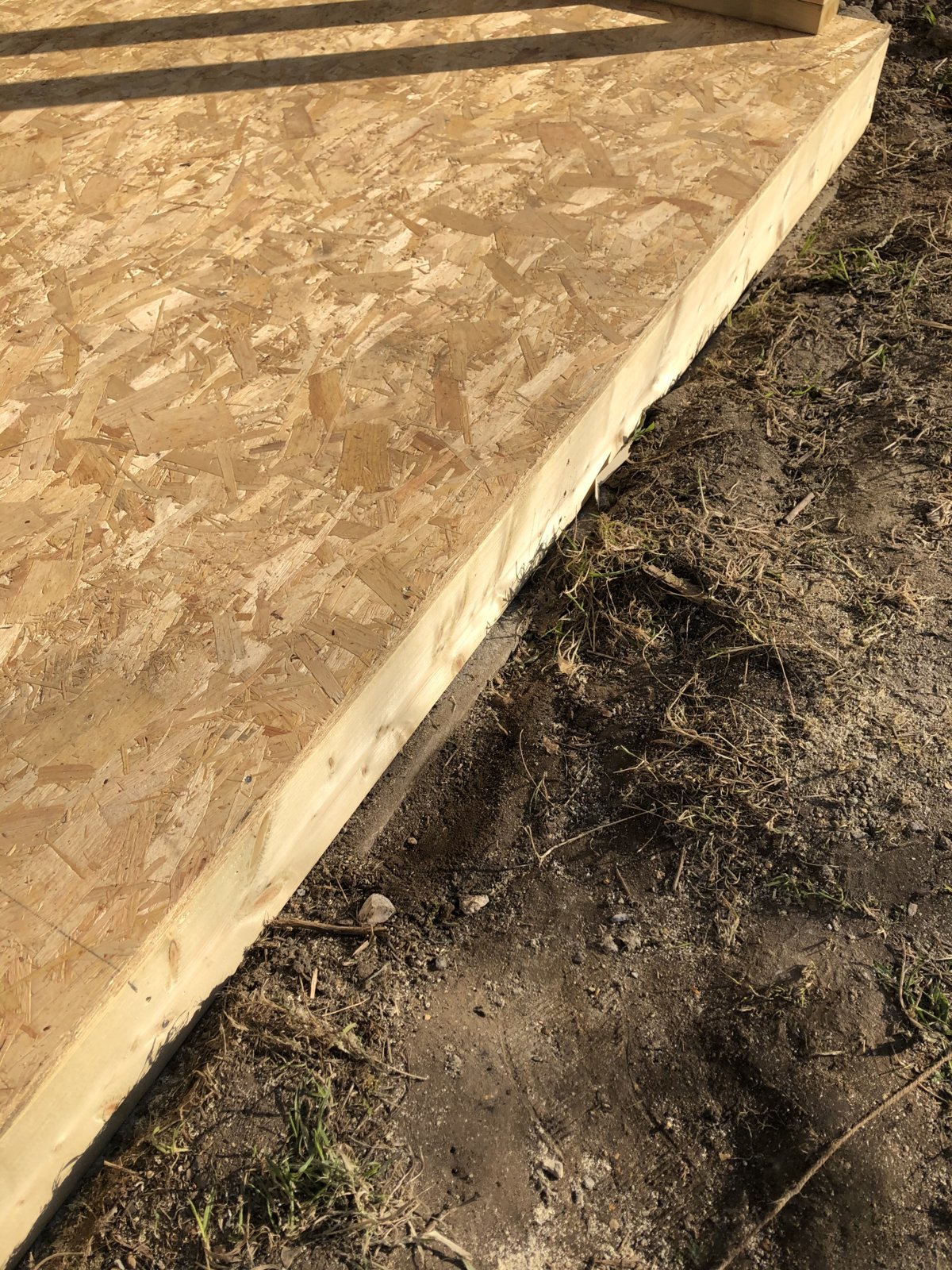

Hi all
I think I've messed up my first (from scratch) shed build. Installed a base, floor and three of the walls, and was happy with how it was going until I realised I had dug the base out too deep and the shed is sitting 5-10 cms below ground level. The base is also is sitting directly on the slabs. So when it Twain’s when it rains, I'll have a shallow swimming pool below my shed which the joists are going to be sitting in.
My questions is, is there a simple solution to solving this issue without taking it all apart? Would just raising the shed off the slabs be enough?
a couple of courses of bricks on your slab will enable you to lift the joists.
And/or dig a French Drain around the slab. if the ground is not porous enough for the water to soak away without rising above the slab's dpm, lead it away from the shed, sloping downwards, into a soakaway. If there is no dpm, the timbers in contact with the damp concrete will rot.
Also, fit good gutters and downpipe to the roof of the shed so that water does not run onto the ground around it. A garden waterbutt is useful, but have an overflow near the top to take excess to your soakaway.
the plastic things have insufficient lift.
yeah, noticed that after I posted it. The ground is pretty uneven around the shed, and the highest point is about 6cm. Rather than bricks, was going to get the some concrete blocks delivered. Shouldn’t be too difficult to jack up the shed and place them under? Ive only got the base and three walls to lift.
Took a quick photo this morning to show issue.

Some 4x2 flat or on edge around the bottom and under the floor as necessary.
Thanks woody. My issue was the timber of the base sitting in water, so placing more 4x2 under it creates the same problem? Unless I misunderstood your advice?

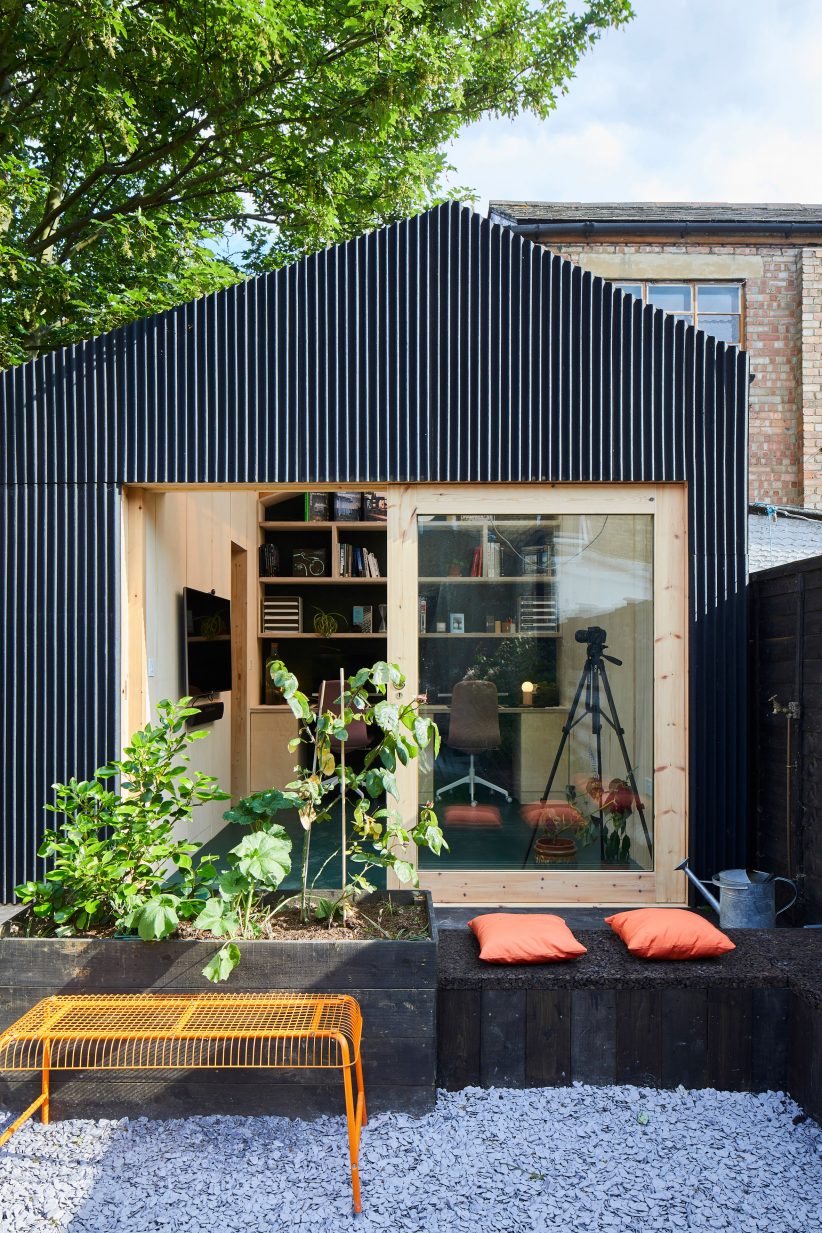

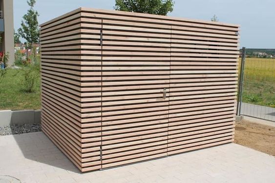

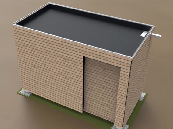

I'm essentially trying to create something like the attached photo, just a bit longer. So no over hang and a flat roof. Drainage, is it best to construct something like the 2nd photo? With a downpipe leading to a waterbutt?

Would it really be sitting in water. Surely there is some run off. As long as its tanalised timber it will be OK to get wet, as long as water does drain.
View attachment 186631 View attachment 186632
That does look nice, but the issue with that type of design with no roof overhang, is that rain saturates the timber and it weathers terribly from the top.

I don’t think it will pool, but form what I’ve heard, having the timber sitting directly in the paving isn’t recommended? It’s pressure treated.
I can dig an area around the paving and fill with pea shingle to help drain. Do you think that would be sufficient?
