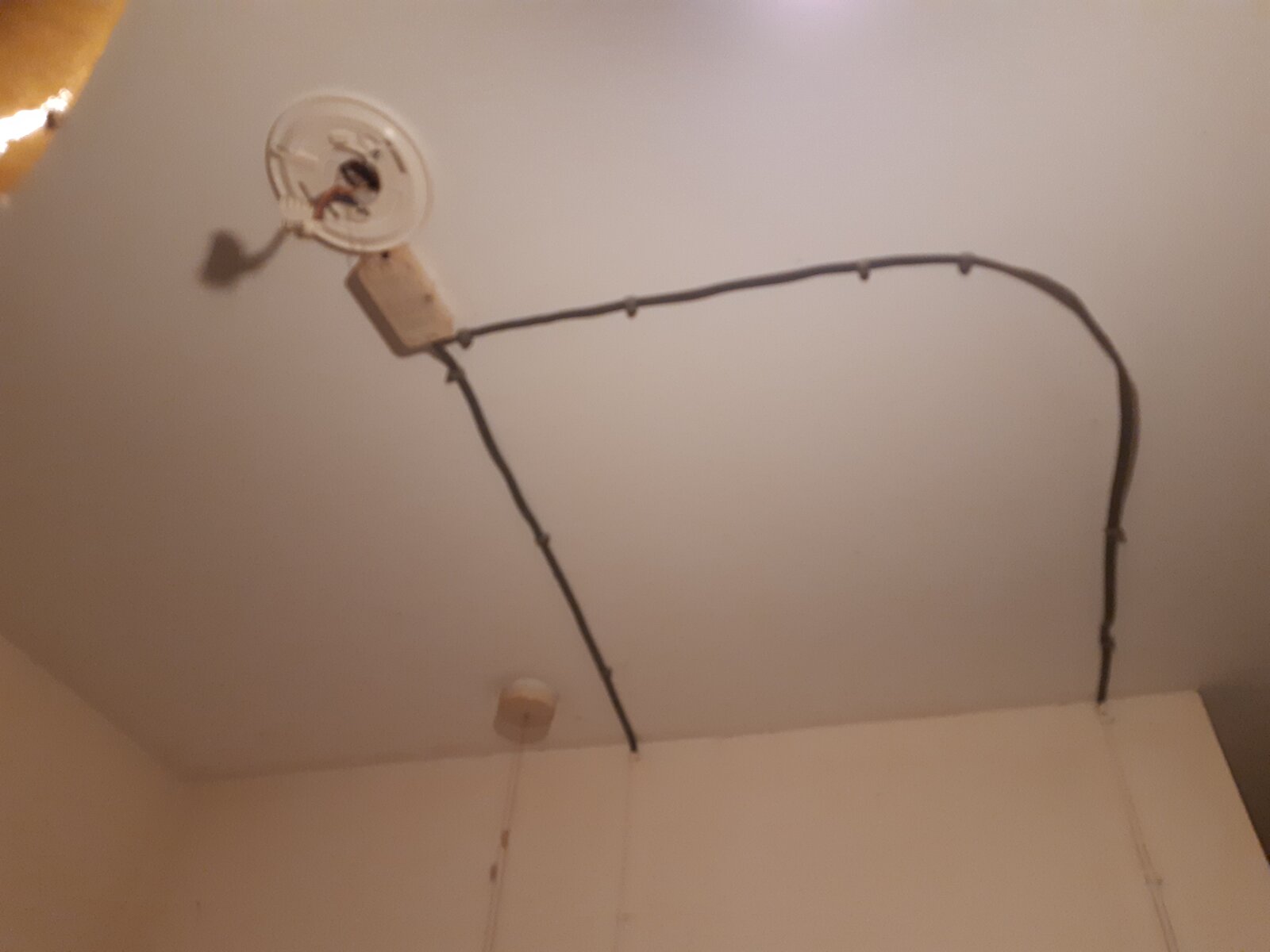

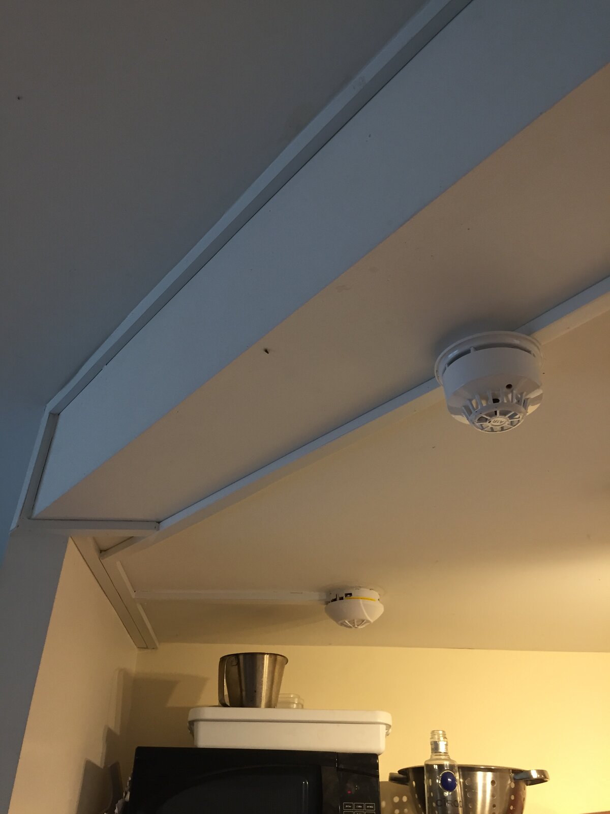

Hi, Ive just had a fire alarm fitted, grade a, and interconnected mains detectors in each flat.
Its been done in trunking and looks messy to me, is this normal ?
thanks

It really doesn't look that "messy" to me. For mini-trunking I would have said it's actually very neat.
i had a look theres no metal supports in the trunking
It may not necessarily be every fixing. It only needs to be sufficient to prevent premature collapse of the wiring system in the event of a fire. So for a cable running through a masonry wall at either end, it may only need one or two in the middle of the run to prevent premature collapse.
Or, of course, it might be that none were used. In which case there's a problem.
