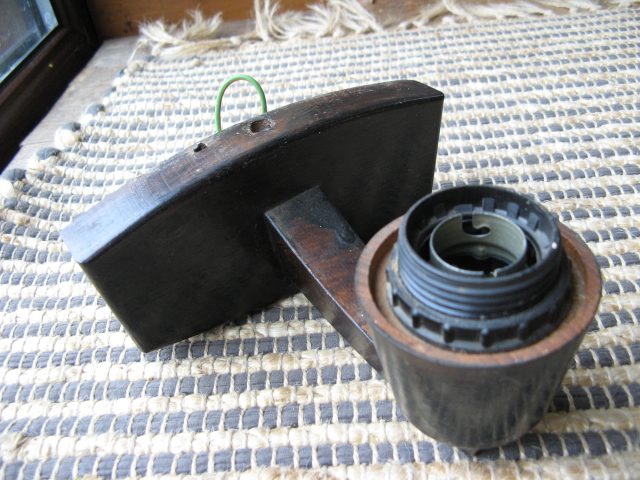

Hi all
I've got a couple of wooden wall lights... I've just had them off the wall and I see that they are not earthed.
There is an earth on the lights. And there is an earth on the mains feed. So I'm presuming that it would be a good idea to connect them. But at the same time I'm wondering why they weren't connected before.
So in case I'm missing anything, I thought I'd best check with you before guys...
Cheers

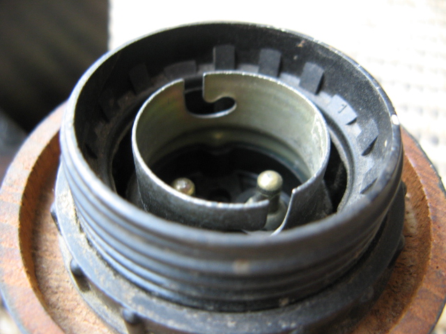

The bulb holder is metal. The rest is definitely wood.... If there's no possible harm in earthing - or if indeed it should be earthed - then earthed it shall be!
Sorry, when I said bulb holder I meant the actual but the bayonet fitting locks into. From what I can tell, the bit surrounding that is plastic...
But you said there is an earth on the lights. I thought you meant an attached wire or a screw terminal.
If it is just a pendant bulb holder fixed to wood there is probably nowhere to attach an earth wire and no metal to touch.

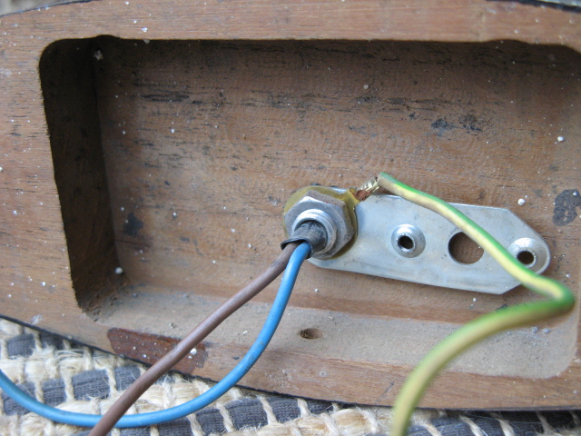

Ok, here we be:
Well, it looks like someone has connected that 'earth' wire to the bracket (which is just being used as a washer) because they thought they should.
I doubt it is connected by anything metal to the lampholder.
Either way, you may as well connect the green/yellow to the supply green/yellow.
It won't do any harm.
The hole in the bottom of the wooden cannot readily be reached, but it would be probably be wise to earth it as advised because a child - for example - could poke a piece of wire up it and make contact with the metal parts under conditions where they have become faulty?
Blup
Thats quite a series of events, a very dextrous child finds a length of stiff wire and manages to poke it through a small hole during fault conditions
If they were that adventurous and determined to do themselves harm, rather than wait (probably for a few lifetimes!) until the "metal parts became live because of a fault", they would probably be better advised to remove the bulb/lamp and plug their fingers into the holder (all that, of course, assuming that it was switched on) :)
