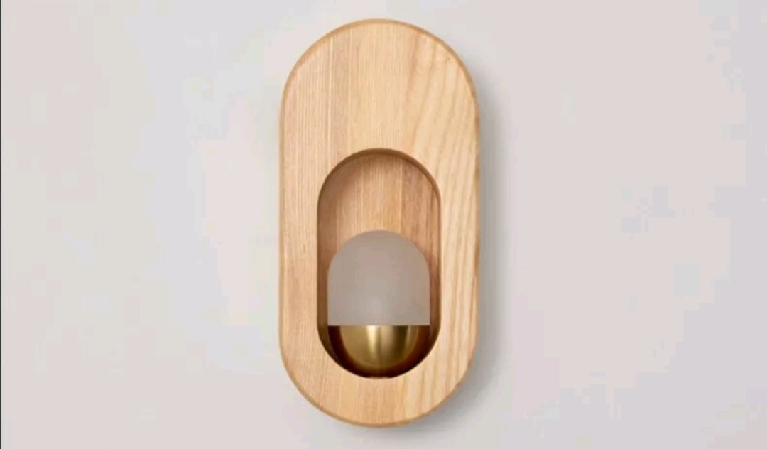

Wooden Wall Light....no earth
Just because it’s been done doesn’t mean it’s right or safe, right?

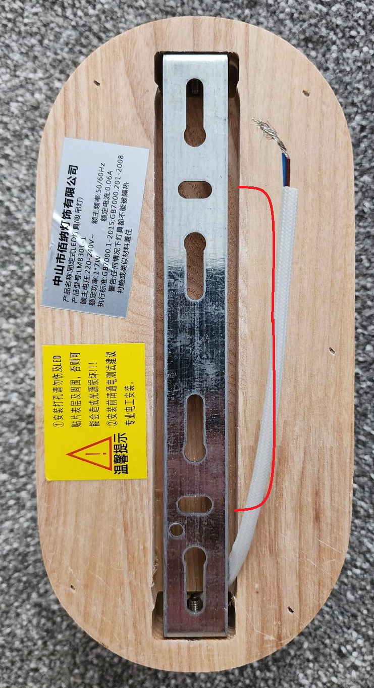

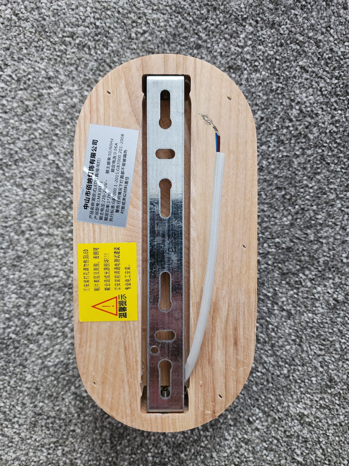

and to close the loop what makes that wooden light fitting perfectly safe according to our magnificent British standards... that bit of white insulation tube with the tails poking out .... as the final connection is not contained within the fixture.... hence its class 2. See all the other shonky metal light fittings that use that to claim class 2.
