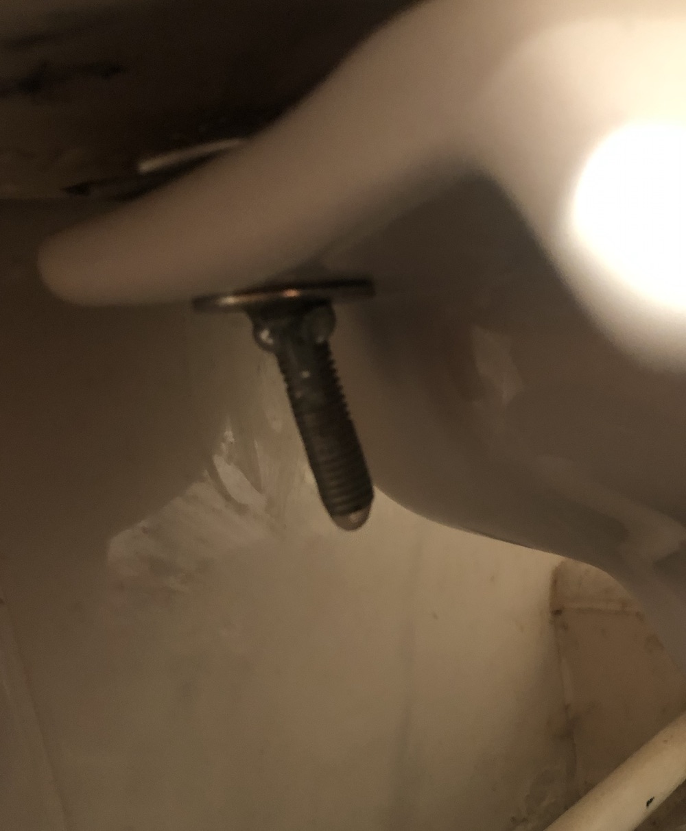

    A couple of months ago I replaced the flush unit in a close-coupled toilet, and I resealed using a new doughnut and a ring of Plumber's Mait on both sides of the (new) metal coupling plate. I let the cistern refill as soon as everything was reinstalled.
    Everything seemed fine, but I've now got a regular drip from just one of the two bolts that hold the cistern to the bowl.
    When I reseal it, should I leave the Plumber's Mait to dry before refilling the cistern?
    And should I tighten the plastic backnut as much as I possibly can, or should I just snug it up? I'm wondering if I possibly tightened it to the point that the Plumber's Mait on the side of the bolt that's now dripping got squeezed too thinly to let it seal properly.

    I’m not entirely sure that plumber’s mait does dry. However that bolt appears cockeyed, so if it is, this would be the 1st place I’d be looking at.

    Plumbers mait doesn’t dry :)
    How come you used plumbers mait in the way you have?
    Everything on a toilet doesn’t need to be tightened to within an inch of its life.
    It’s the doughnut washer that is creating the seal.
    • Like Like x 2

    If the nuts and bolts aren't sitting straight in the hole then the cistern isn't fitted square to the pan. Over time the doughnut and cistern has settled and the doughnut is now out of alignment and starting to leak. The cistern needs lifted, new doughnut added and then sit the cistern down square onto the pan platform and then tighten the wingnuts down equally either side.
    Hopefully the pan is sitting the correct distance from the wall otherwise it will never sit squarely to the wall and the pan and you will always have issues.
