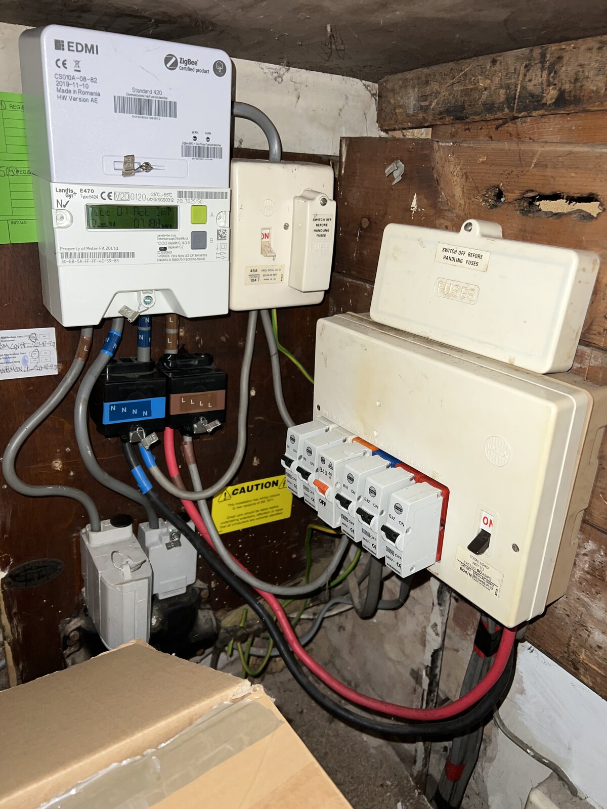

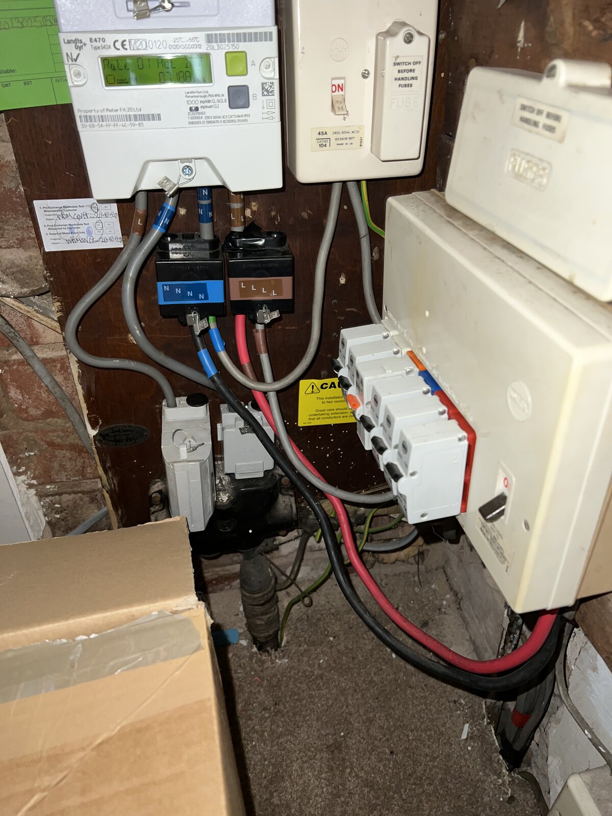

I recently moved into an old house that was generally in need of some TLC. Been ripping out carpets and stripping walls ever since being worried about asbestos etc but it’s been in the back of my mind that maybe the electrics are out of date.
How is this fuse board looking, unsafe? I always feel safe in a home where the electrics trip properly when something goes wrong. Is that an RCD protection? And in this case is that absent?

I think that's from the late 80's with what looks like wire fuses in a separate box, so worth uprating for protection to current standards. Specifiy rcbo's which give individual rcd protection to each circuit, useful if a circuit fails because others will not trip at the same time.
Your electrician would advise you on what's suitable for your property.

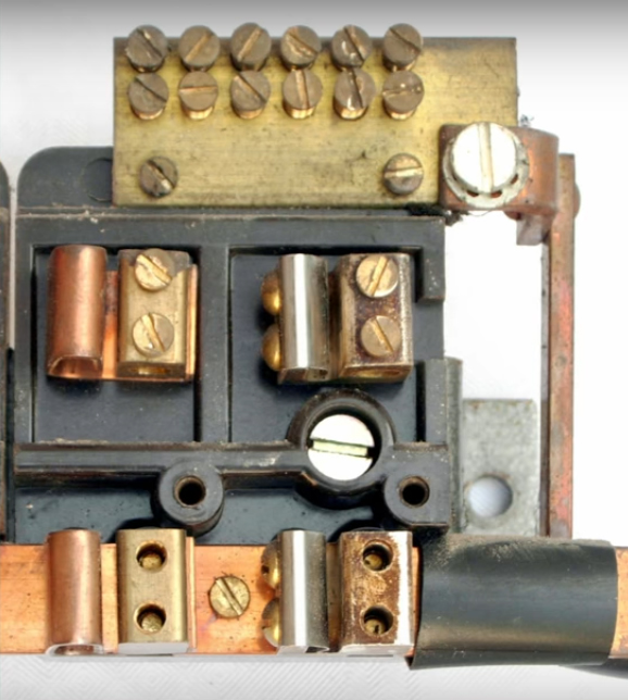

The old Wylex fuse box with MCB's fitted should have any MCB over 32 amp right next to the main switch as only that one had the extra reinforced clips. Wylex heavy duty.jpg Also the main switch on most was rated 60 amp Wylex 60 amp.jpg so it limits supply to whole house as DNO can't uprate their fuse if the isolator is only 60 amp. However they were a good box, and the electrical safety council says
so can't say it must be changed, but I would and did change the one in this house. I fitted a fusebox (that's the make) consumer unit with all RCBO's and a surge protection unit, seem to remember the bits cost me around £250 there are boxes with just two RCD's which are cheaper under £100 but fitting cost is the same and the problem with duel RCD's is one fault can trip half the house, and loose a freezer full of food and that is far more then the extra to fit all RCBO's, so really silly to fit twin RCD's.

The fusebox is obsolete, meaning you can keep it exactly as it is if you want, but you can't add any circuits or extend any of the existing ones.
Whether a rewire is needed depends on various factors. Either way, that old fusebox needs to be replaced.

RCDs are a third layer of protection. Newer editions of BS7671 have steadilly increased the number of situations in which they are required, so under current BS7671 most domestic circuits are required to be protected. As an owner occupier you aren't under any legal obligation to update your installation to current standards, but you may find it difficult to find electricians who are prepared to extend a circuit without RCD protection.
Indeed there is no RCD protection in your current setup.
the electrical safety council says View attachment 263523
They do say that, but they also say that "Absence of RCD protection for portable or mobile equipment that may reasonably be expected to be used outdoors" is a C2 and hence will result in an "unsatsifactory" result on an EICR.
There are undoutablly some flats, where use of portable equipment outdoors from a socket in the flat is unlikely, but for a house or ground floor flat I think it can be reasonablly assumed that at least some sockets will be used to supply equipment outdoors and hence a total lack of RCD protection is likely to result in an "unsatisfactory" EICR.
Now it would certainly be possible to add RCD protection to sockets used to supply equipment outdoors without replacing the CU, but I don't think it's sensible. Adding RCD protection before the CU would leave you with a single RCD protecting almost everything, which is troublesome if it trips. Adding RCD protection after the CU is ok if you only need to protect a single circuit, but if you want to protect most/all circuits it's going to get very messy and be more work than just replacing the damn CU. I guess you could add a RCD for the downstairs sockets only and get a minimally "satisfactory" result, but you would still be left with an installation that was problematic to extend/modify in future.

In this case looking at the pictures it does seem it is a TN-C-S installation so that is true, I make that point in case some one other than @K-Duffy reads this thread, RCD protection in this case is secondary protection, if it was a TT installation this would not be the case.

I don't know what the 45 amp fused isolator is for? But at moment you have 7 circuits, my house has 14 circuits, so there was a large jump in price for RCBO or twin RCD in my case, but in your case very little in it depends on make used.
