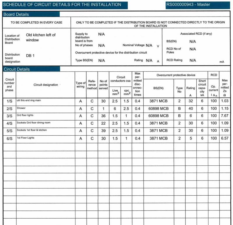

Inspection recommends new CU....

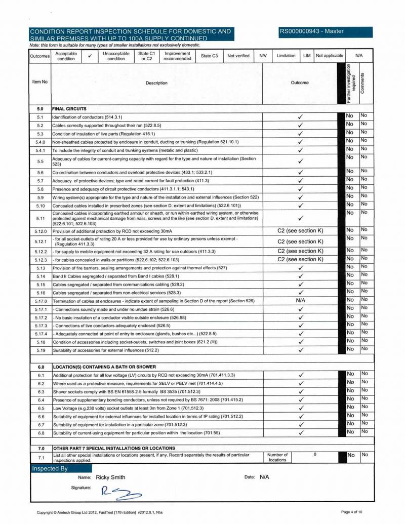

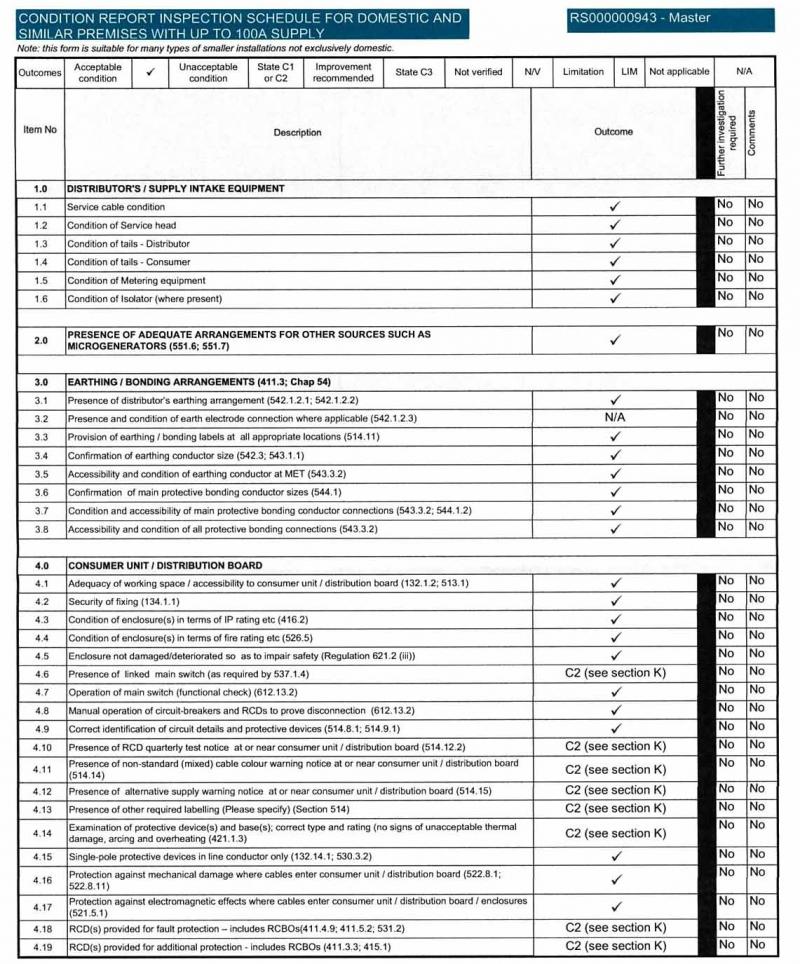

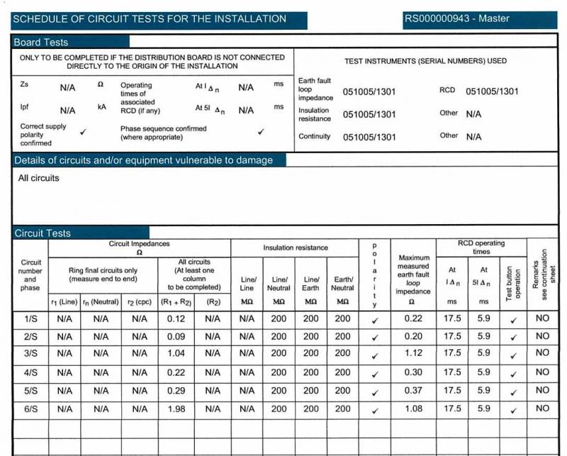

Well the guy who did the quote has come back to me to explain that the CU needs replacing because it doesnt meet the 17th edition. I got him to repeat that.
That's the justification ofr the work, not that it is in any way dangerous.
Then he is just wrong and making money from unnecessary work.
You need a new car as well as yours doesn't meet the latest requirements.
That's what I gathered from the comments earlier. Think I'll pass on this for now. I get that to update the house elctrics ata leter date might mean an upgrade though as presumably any new circuit would mean a new CU?

The parts being discussed are not "faults".
Even the inspector has said it is not dangerous.
so Grabitt & Screwem Solicitors could well use that to justify why you owe their poor and deserving client a bucket load of compensation (edit) for their injuries which you know to be caused by them being a muppet (or self inflicted, or completely false) but which Mr Grabitt will claim was your fault for having dangerous electrics.
Which regulation affords protection against liars?
You know that, I know that, you can be sure that some people will be happy to equate "doesn't meet current standards" with "not safe". After all, "if they changed the standards it must have been to improve safety right ?" Bear in mind I've recently witnessed what I believe to be outright fraud* that's cost someone's insurers around a grand (probably more after addons for "costs") - simply because they couldn't justify the cost of defending an action being pursued by a Grabitt & Screwem type outfit.
It's sad that these days so much is not based on what's being reasonable, but on not leaving room for scum to scam you.
I wouldn't be bothered by most of the items, but having seen how some people behave, I'd be looking hard at the best way of dealing with them. Stilll, unless there's some other stuff we don't know about, £2k seems "rather steep" and I suspect the agent is acting in their, not the landlord's, interests when it comes to suggestions for tradesmen and pricing.
