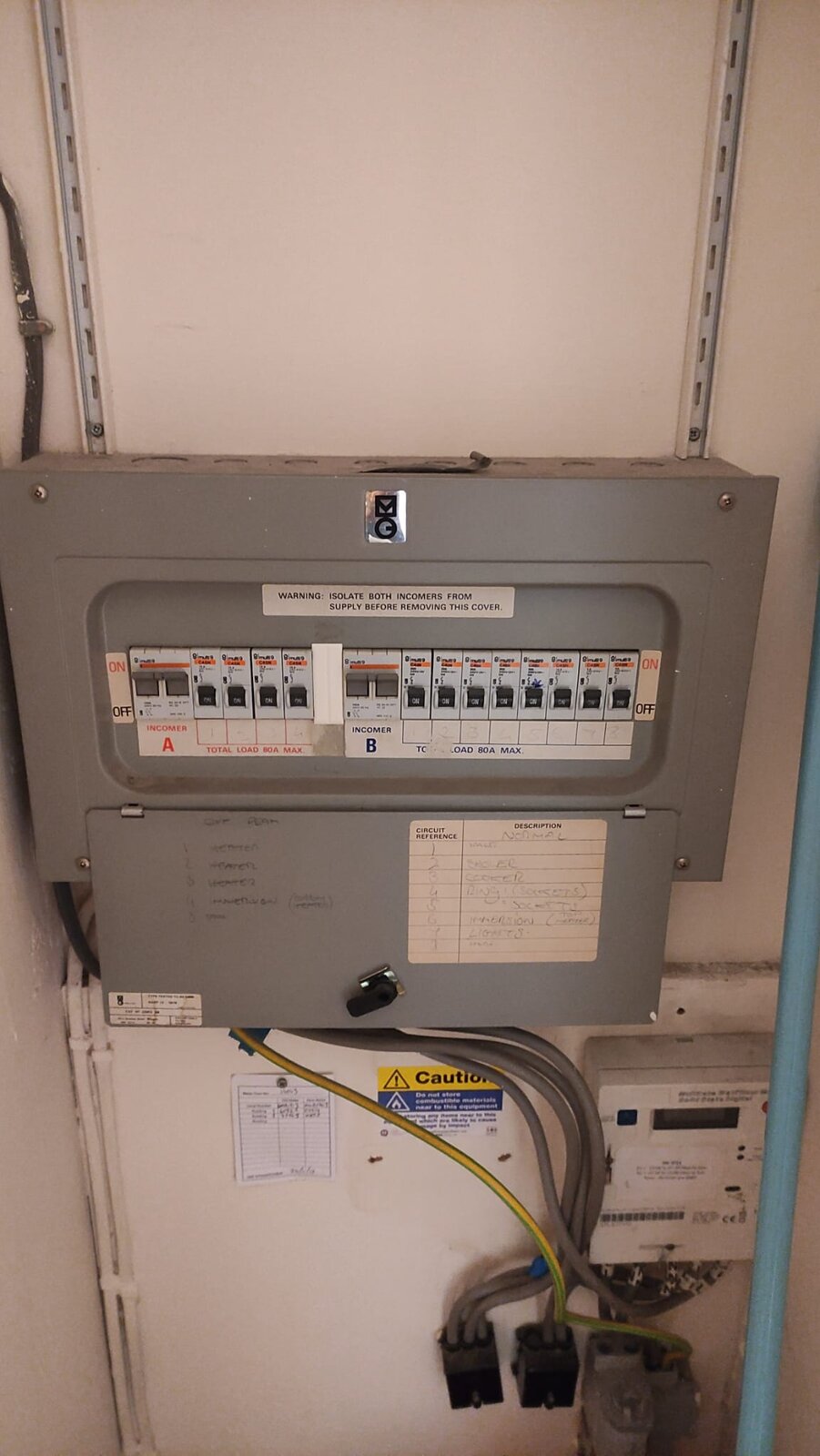

Does you rental agency agreement not insist on a single point of isolation?Hello. Just after a bit of reassurance really.
We had an electrical inspection carried out on a rental property and the electrician says we need a new consumer unit as the current one is too old. He said cost would be between £500-£1000 and that it he would need to source a special unit as the flat has white meter heating.
Unit is probably about 35 years old so I suppose it is right enough that it needs to be replaced.???
Many thanks.
Craig
Both of mine do.
