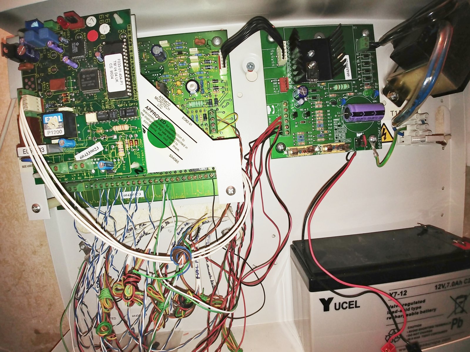

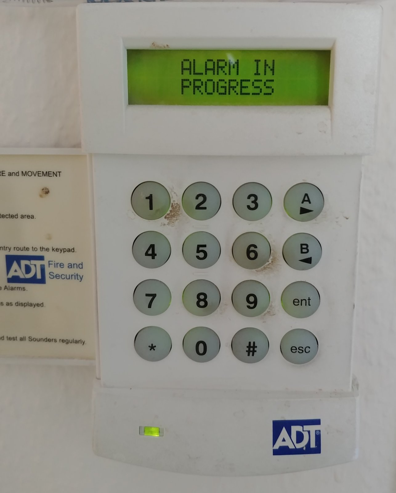

I've moved into a new home where there is a Microtech Galaxy 18 C051 system installed with about 15 PIR/door/window sensors and a few panic alarms.
I haven't been given any of the codes so the alarm just bleeps and displays 'Alarm Im Progress' - I can't seem to get rid of this.
Should I update my system or is there another solution that's not disproportionately expensive? If so, what can I update to so I can make use of the PIRs that are already installed? Preferably something I can do myself. Thanks in advance, A

This is what I have at the moment:

Sorry to sound ignorant, I've searched this forum as well as others all day - could you point me to how I can default the panel?
Page 2-9 eng manual galaxy 8,18,500

Once defaulted, enter the master code 12345 and 'ent'. You will then need to use menu 48 to enable engineer access. After that, use 'esc' to come back out of the menu, then enter as engineer 112233 and 'ent'. The system is now in engineering mode. You will need to reprogram the zones. Use the menu 'Display -> Zones' and get someone to trigger each sensing device in order that you can tell which sensors are connected to which zone. Once you have that sorted out, come back and we can help with the rest of the programming. The panel is likely to have ADT based firmware, so will need a few options changing to overcome the ADT defaults.

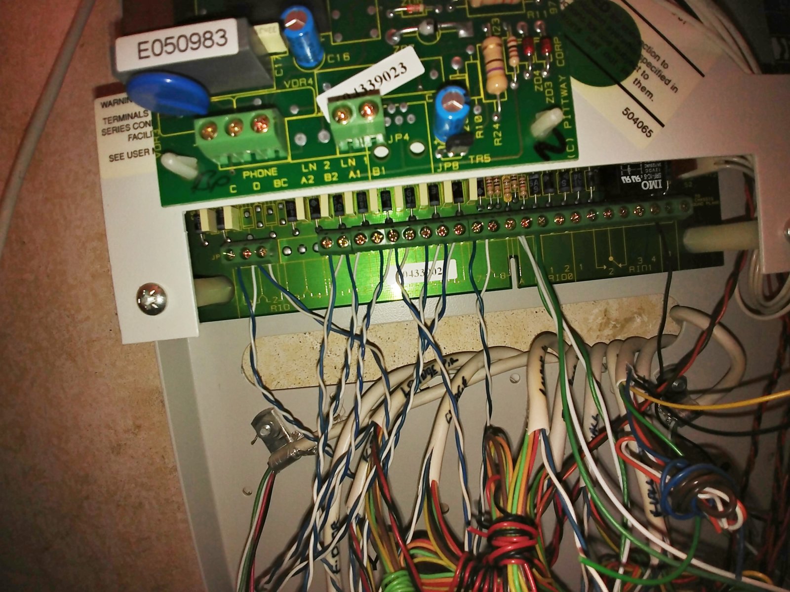

So I tried to default the panel but wasn't successful. Not sure whether I did it wrong or whether it just refuses to work. Still end up with the same message. Also tried following some steps posted previously on this forum. I have all the manuals to hand.
Would anybody be kind enough to provide a step by step on how to reset it? I've attached an image of my panel in case that makes things easier. Thanks again in advance.

Power down the panel completely (mains and battery)
Open the memory link (it's the blue thing with a wire link in the middle, just to the lower left of the black ribbon cable on the right side of the main PCB)
Power the panel back up and close the link.
The panel will be completely defaulted so will require totally reprogramming.

So I tried it, but it didn't work. I've attached a video of what I did (I tried by also connecting battery first and by disconnecting the external fuse).
Strangely, the system doesn't work at all when only the battery is connected even though I bought a new battery.
Any other ideas or other things I could try before scrapping it and accepting defeat? Thanks again!
Not sure what you mean? You default, then boot. You then need to enter the master code 12345 'ent'. What happens after that?
