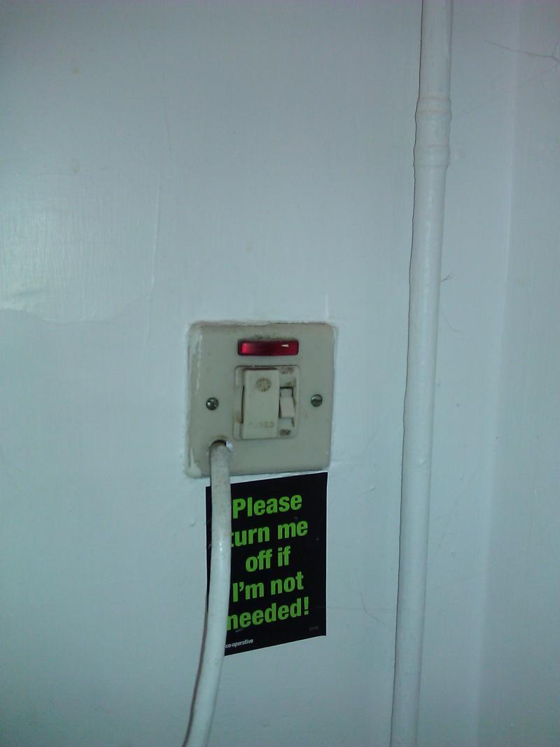

Theres a few of these in a place I visit often, but most are disused. This one isnt, and is happily supplying a rusting 2 gallon stored water heater.
By the way, when the fuse holder is removed from these, are there exposed live parts? Theres a couple, not used, with missing fuse holders, but they may well still be live.
When were these last fitted?
These were last fitted just after 1970.
From memory with the fuse carrier removed there aren't exposed parts as such, yet hardly ideal as perhaps something could be inserted into the holes.
There's nothing wrong with them, infact I probably passed those very switches on the periodic :lol:
The fuse holder has 2 blades on it that push into two holes on the FCU, so there is nothing live exposed it's just like an unshrouded socket.
It's not ideal, but not really a massive risk.
I'd imagine it's probably 30 - 40 years since they were fitted as they pre date both MK logic and MK logic plus ranges.
Its probably better made than a lot of switched fused spurs you can buy today, Don't see the issue other than it looks a little old hat
Fugly things though arent they!
No, I don't think so at all. They have a great retro feel now. I'd like to see this range brought back, though perhaps with a more slim-line profile at the back to save chasing in 35 mm deep flush boxes!
Surely it's just like an an unshuttered socket, i.e. the type not permitted by the regulations?
I don't know where/what this place but "a place I visit often" doesn't sound like a private or controlled space, so I'm not sure that IP3x (probably) is OK for live parts.
Indeed, they are unshuttered. .. but how do these FCU fuse carriers differ conceptually (other than having smaller blades, hence smaller holes into which to poke things) from the fuse carriers which are to be found, say, in many a CU?
