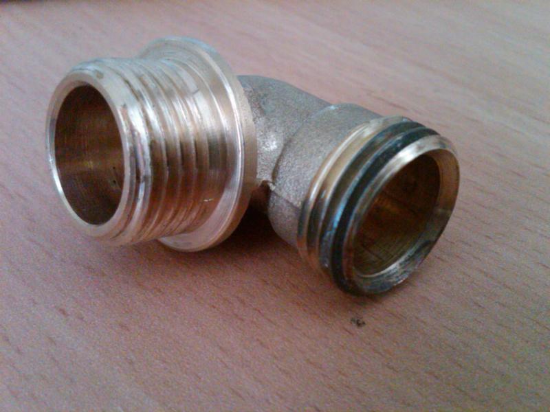

I fitted the valve and pipework and left overnight, I even tested the shower (having flushed the system first) and it all works brilliant BUT...
Problem.... the intention being to leave for at least a week prior to tiling to check for leaks. Lucky I did, the Hot side of the elbow joint into the valve is seaping very slowly :( This is one of the elbows relating to my OP, I couldn't screw it in the full way because it didn't then point downwards and so I wrapped it in 10 wraps of double PFTE and it felt stable...but is leaking.
See the pic below, the elbow that is leaking is the joint at the top. The bottom joint is a compression and seems fine.
The instructions state not to use any form of sealing compound but would I be best removing the elbow, covering the thread in sealing compound, positioning correctly and leaving to set fully?
Gutted! :( it was all going too well!
the man has told you already, Loctite 55 will make your life much easier.
majority of plumbers would happily do the job with ptfe but it probably requires a bit of experience with the stuff which many of us take for granted, especially when it comes to having joints facing a particular way.
Christ alive you don't need Loctite :rolleyes: PTFE is more than adequate, you just didn’t get it right this time; it’s inexperience, you didnt get enought to stay in the thread it happens, just have another go at it; I assume you wound it clockwise! ;)

I'll checkout this Loctite stuff but in the meantime, Richard can you give a brief lesson on how to secure such a nut with PFTE for future reference :D

Are you being sarcastic :?: taking the pi ss :?: My comment about winding it clockwise was a genuine suggestion as to where you could have got it wrong; if you wrap a right hand thread anti-clockwise, the tape will unwind when you screw in the fitting as your going in the oposite direction to the lay of the tape. In case you think I’m making it up, I managed to find this old thread for you;

No not being sarcastic at all, genuinely wondered if there were tricks to getting it right other than winding clockwise neatly (which I always do) - just arriving at Screwfix now to get some Loctite 55, looks like good stuff!
I have just removed the elbow from the shower valve to remove the old PFTE and give this loctite stuff a go - remember that the valve has only been connected for a few days to the water supply, and yet upon undoing the elbow it has some odd discolouration already on its thread, is this fine or an indication of a poorly manufactered elbow/material?
If I run my fingernail around the thread, where the discolouration appears it feels a bit rougher?
It is also worth pointing out that the discolouration only appears on one side of the elbow, the compression side (the other end isn't compression and just screws into the shower valve).
It is the same case for both hot and cold elbows.
