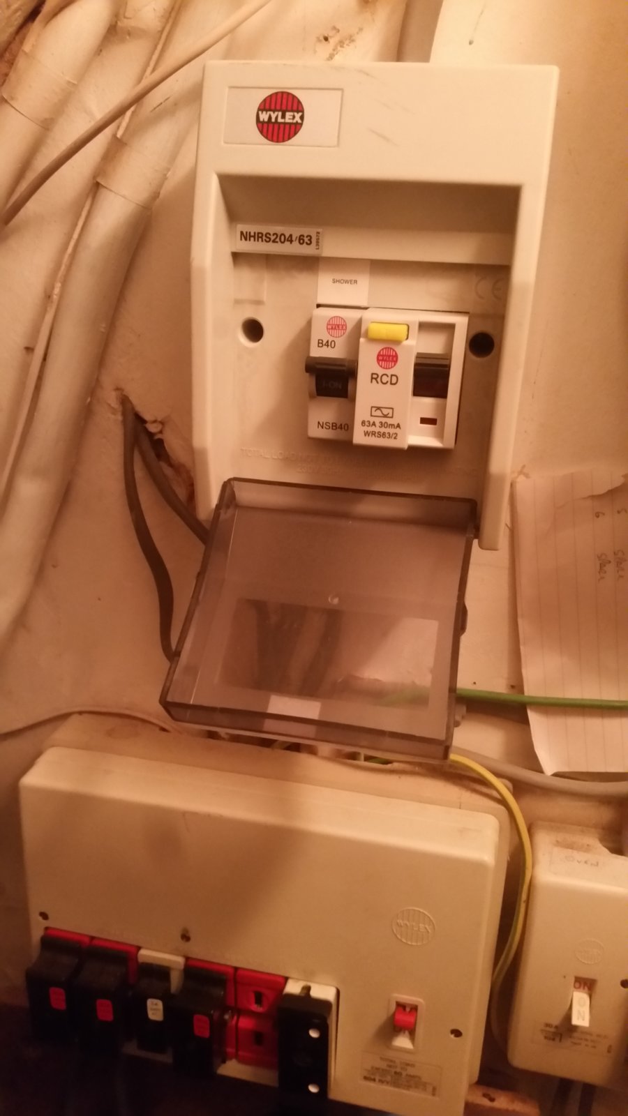

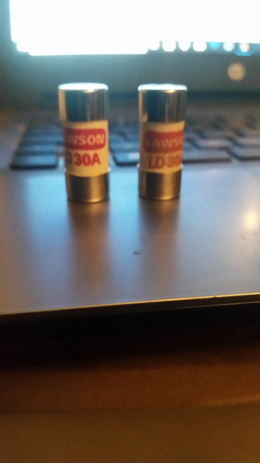

Sometimes a picture can speak 1000 words. Attached are the external MCB/RCD and the main fuse box (the missing slot is the 30A fuse I have taken out that was for the shower).
The MCB nor RCD tripped on this circuit, just the fuse blew. The pic of the two fuses shows the brand new one I bought today on the left and the old one of the right... looks older and dirtier but I don't know if that just happens with age or with heat/wear.
Based on the replies so far, I am thinking I can replace the fuse and put this down to wear over time of the fuse but overall, the set up needs an update?
You can replace the fuse and it will very likely work for a length of time, possibly even years.
However the fuse is being run at more than 30A, that fusebox isn't designed for anything over 30A, and the whole lot is well past the time it should have been replaced.
No RCD protection on the other circuits either.

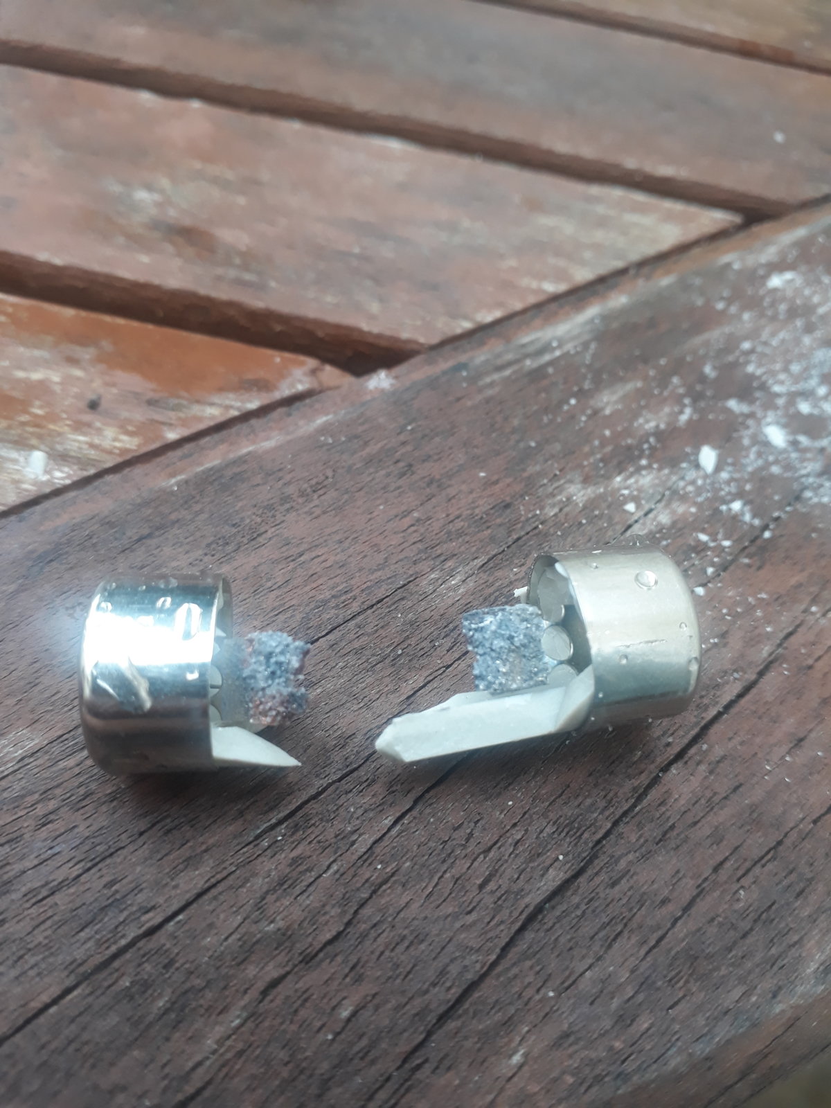

Now you have the new fuse, you could crack the old one open carefully, squeeze it with pliers, be carefull sand may come out of it, looking at the fusewire inside may help explain whats going on, though it does seem like long term overloading, so the wires likely discouloured, if it had been a major problem it would likely have little round balls of copper inside
I had to put the fuse in a vice to split it, pliers only made a scratch.
This is a picture of what I found inside, apart from white sandy stuff which all spilled out.
Difficult to be sure, but that fuse looks as if it has been blown by fault current, rather than an overload. It possibly suggests the shower itself has a dead short internally.
