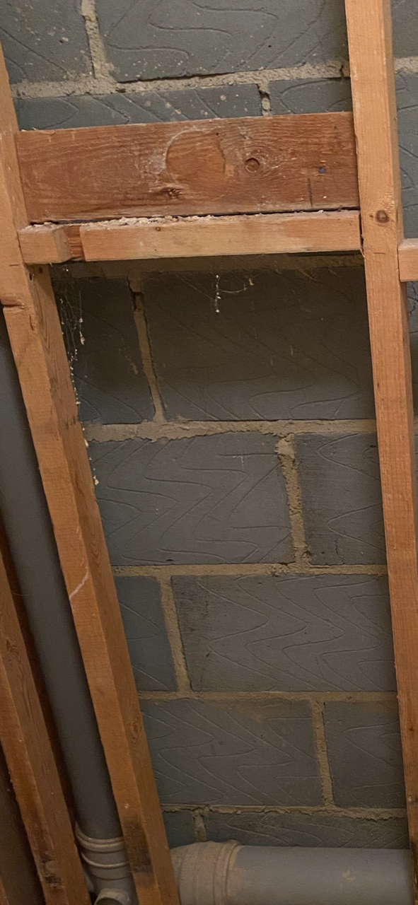

As attached nothing there at the moment.
Is it more tricky to install then as the Mira one attached to 2 copper pipes coming out of the wall but this looks like it has to be attached to a treaded connection.
Just wanted to double check this isnt goign to be a pain to install before i order it.

The 'threaded parts ' come with the shower and will be a nightmare to use .Best to get a shower plate fixing which will bring the pipes out at correct width .
Pipework can then be capped and tested before the wall goes up.

Ok, so I can still order this shower but should get a plate fixing. Can you send us a link to an example.

ok so if I get a plate fixing kit, the 2 copper pipes can be left coming out the wall like my Mira was?

Multiple ways to fit the shower. Your installer should have no issue as it's a standard fit for a bar shower. A plate kit can be used or a shower fitting kit, kind of depends on what the finished wall surface will be and how deep that will be.
Just make sure you use a plumber who is experienced in installing showers. Don't use any other trade or it could end up being bodged.
