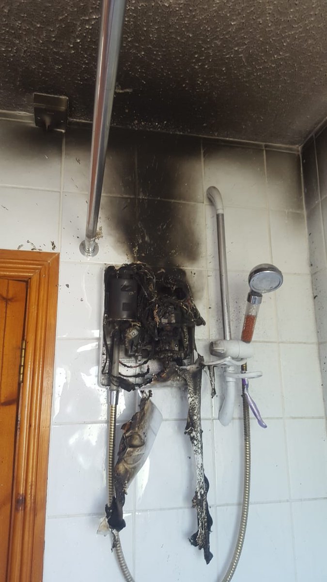

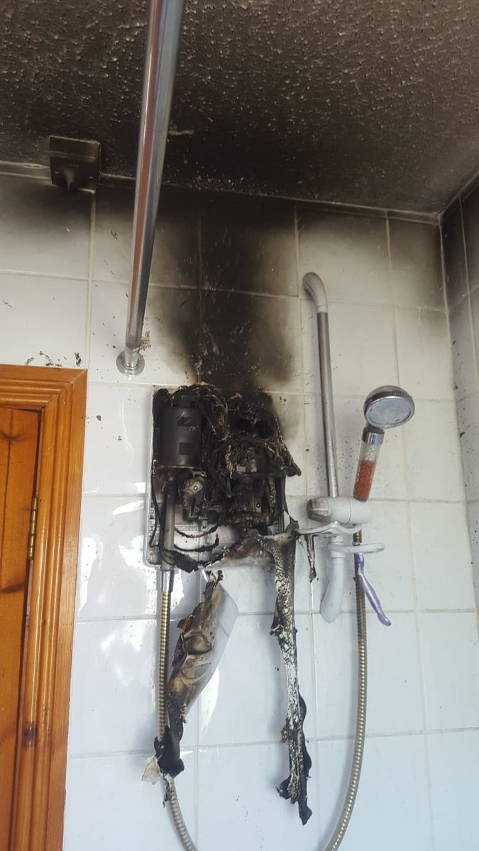

Fit a local isolation switch.
Or in an emergency, find the garage keys, rush out to the garage wet and naked, crawl over the rubbish in the way, and turn off the CU.
Your choice.
Your choice.
Did he say his CU was in the garage? What sort of emergency do you envisage? If it really was that serious it would be a reg surely.
Listen to what the electricians here are advising, and do fit a local isolator.
How do you know it isn’t when you don’t own a copy of the wiring regulations?
I bought the Crabtree isolator. It can then be mounted locally easily i think. Left message on sparks phone so hopefully he calls back!
Blimey that was a touch of deja vu and I had to take a double look. If it wasn't for the varnished woodwork rather than white paint that would have been one of my flats where the tenant repaired the shower unit when the overtemp sensor tripped.
And that Winston is why I will follow MI's which sofar have always included fitting a local isolator. Regs or not MI's are there for a reason and this looks like a very good reason.
