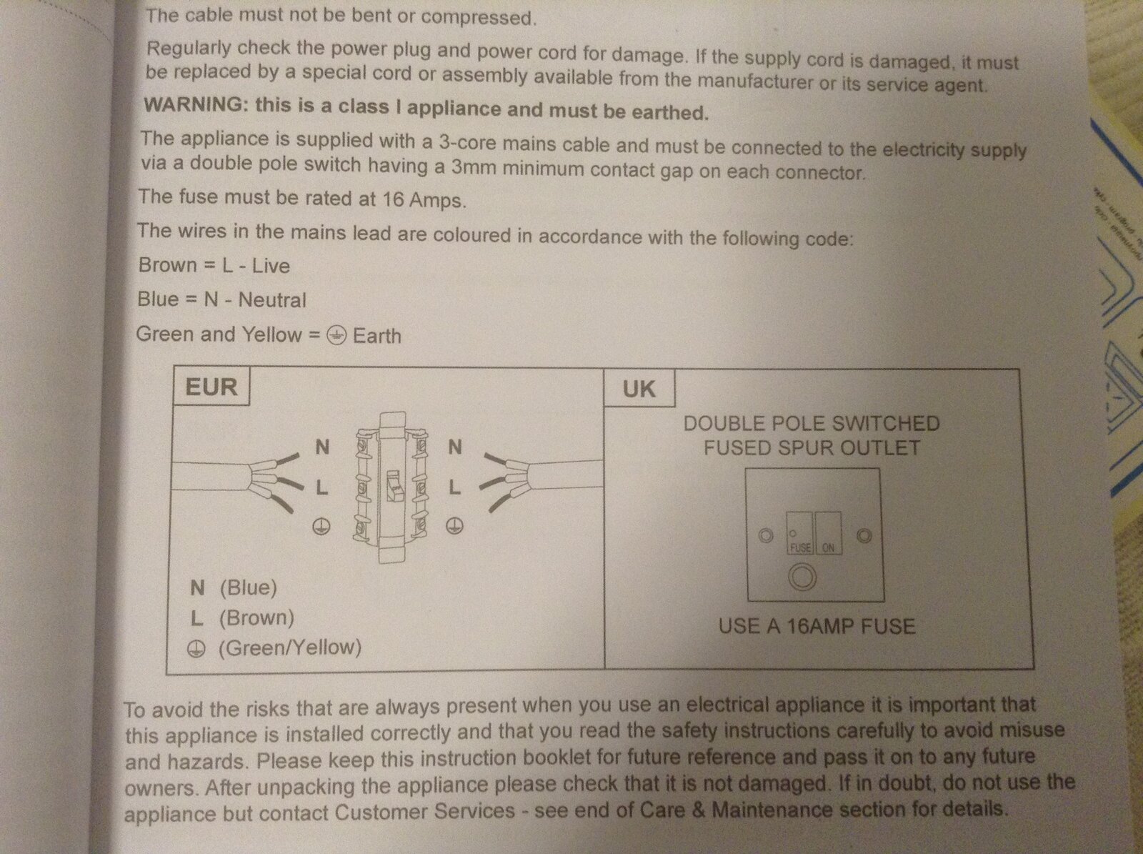

As I have said not having a copy of a book does not mean I don't know the contents. So I am aware of reg 134.1.1 and I fully understand that "shall take account of" does not mean "follow blindly".
There are many instances of manufacturers instructions being dangerously wrong.
e.g. Picture below of MI for a B&Q oven.
It is impossible to follow these as 16A BS1363 fuses don't exist.
It takes a couple of minutes to calculate the load. If this greater than 13 amps, you can't use an FCU.
Given that a 16A fuse is not available, how does this count as 'dangerously wrong'?
