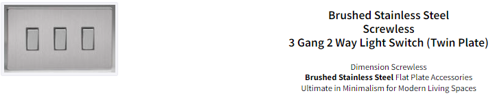

I don't think i've ever seen a regular single piece 3 gang lightswitch that used a 2 gang backbox. Whenever i've seen a 3 gang switch on a 2 gang backbox it's been a modular system.
There are plenty out there - the first Google hit was this one from TLC, and to confuse the terminology even further, it's called "Twin Plate" (maybe to avoid called it a "2-gang 3-gang switch" :) )
I've got a vague feeling there were some 1960s MEM and MK ones that were a single piece 3 gang switch plate designed to fit on a 2 gang box...
As I wrote (and illustrated) last night, one doesn't have to turn the clock back - there are plenty still available today.
Kind Regards, John
Kind Regards, John
Not sure if the one you illustrated qualifies as 'one piece', as the data sheet shows the back of it it to be made up of 3 removable switch modules, which would be useful if say an intermediate is required.
The old MEM and MK ones certainly were in one piece and couldn't be dismantled - without a load of bits and pieces going everywhere.
Fair enough, but I would be inclined to regard that as 'quibbling', since anyone looking at the front would have know reason to know that it was 'modular' (in the sense that the three switch mechanisms were physically separate) :)
