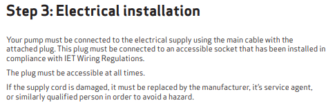

My shower pump has packed up so i need to replace it. The current pump is connected to a fused spur taken from the lighting circuit.
Is it acceptable to change the switched spur to a single socket plate and just plug the pump in. Most are supplied with 3 pin plugs now days so just want to make it easier to swap over when the next one goes. The socket would never be used for anything else. Is there any issue with this?

All done. Thanks for the help. Changed to a socket in the end as the warranty on the pump would be void if i hard wired. I labeled the socket which is in the back of a loft so you wouldnt mistakenly plug anything else into it.
Ok, guess the manual that came with it was incorrect. My bad.
I was only trying to close out the thread by saying thanks to everyone who gave input. I wasn't looking for abuse. I believe i have followed the manufacturers literature correctly and am, as always, greatfull for others helping me to complete a task successfully in areas that are not my expertise.
