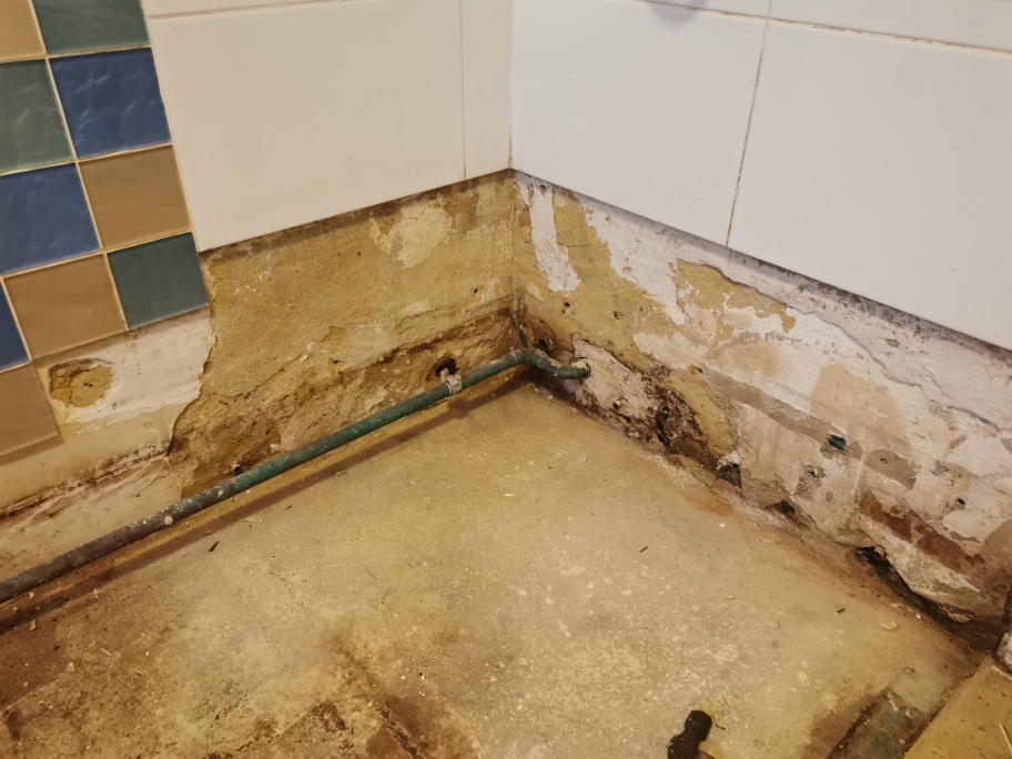

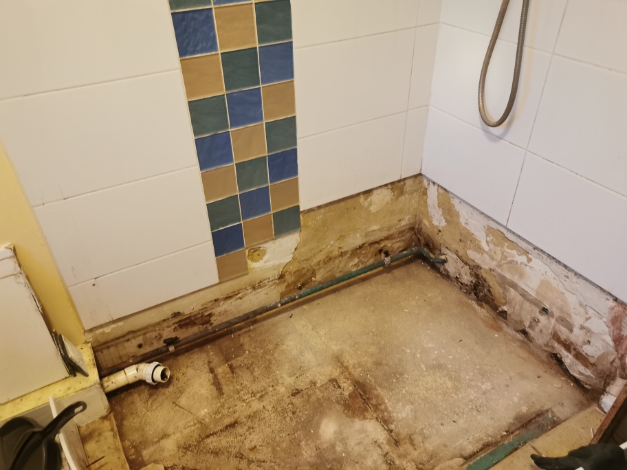

Hi
We had water leak via the enclosure under the raised shower which rotted the wooden plinth. We have taken the shower out and hope to reuse the tray and but in a new enclosure. We have cleared out the plinth and cleaned the wall back some, would the next steps be:
- re-plaster where the tiles have been removed- is there any specific plaster that is good to use for showers? is anything else needed?
- plinth or shower riser? should we replace the plinth or opt for a shower riser?
- put tray back in and link waste back up
-retile and grout
- put new enclosure in and then seal everything
I have added some pictures to show what the area looks like now, have i cleaned the walls back enough?
Many Thanks

Whenever we fit a raised shower tray we build a solid platform from 2 x 3 and plywood. I don't trust the riser kits enough to be solid enough to prevent movement.
Your walls look OK for tiling on
