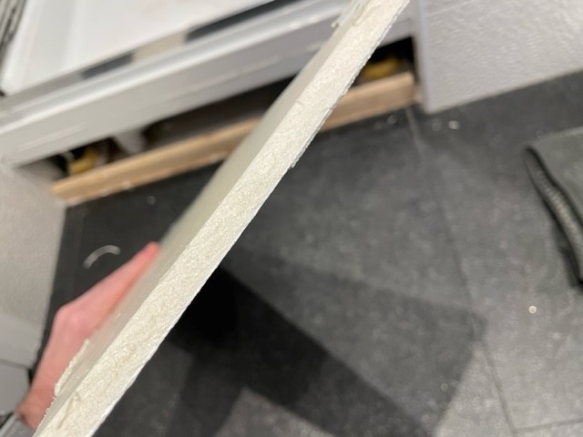

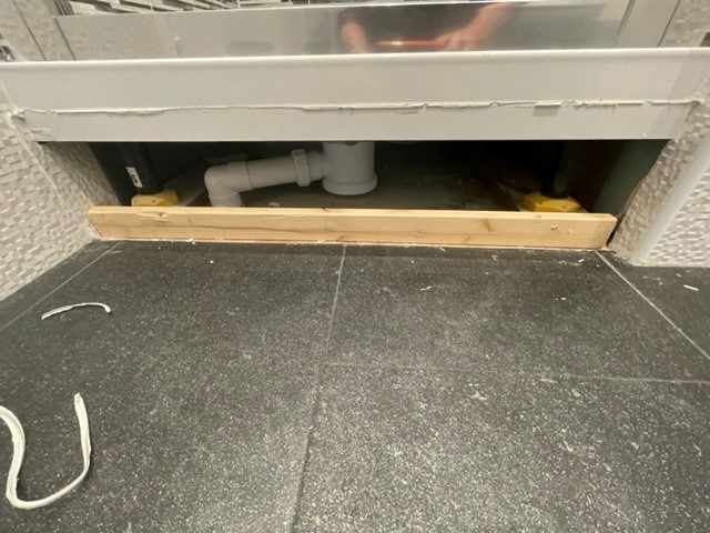

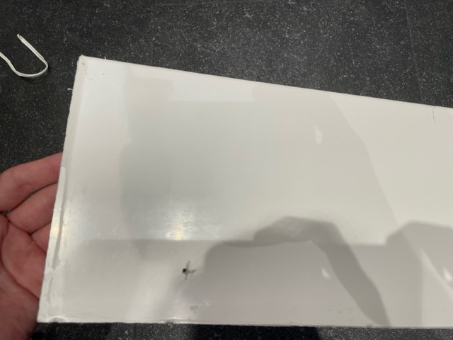

Hi
I recently had a leak underneath my shower tray, the piece that covers the end (shower skirt?) was removed but has been damaged.
This looks like something that has been cut to size, I've tried to find a skirt which would fit but can't find one off the shelf. The dimensions are 73x1x17cm
Can someone help with what I should be specifically looking for - pics included if that helps.

You can purchase a section of uPVC or fit timber and paint it.
You could cut from 200mm white uvpc soffit , local supplier might give you a free off cut (as they come in 5m lengths.)My local supplier has a wheelie bin full of off cuts.
Thanks both - I’ll see if there’s any local suppliers of upvc.
