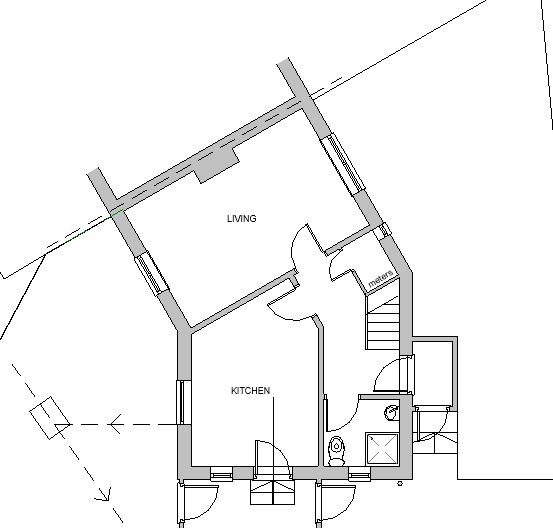

Hi all.
Anyone come across or know how the powers that be decide on the PD side extension rule when the property is shaped thus?
The total width of the front elevations combined or the rear?
Regarding the side being no more then half width of the existing dwelling.
Indeed. Yes. But front and rear are different lengths.
I would like to think they would take half of the front elevation as a whole as the max allowable under PD
They are one elevation, irrespective of how many individual lengths make up the elevation.
The width is taken as the "widest point" of the original house, so that would be the rear elevation total width by adding the two planes, and not measuring direct between the two outer corners
The width of the house is "the width at its' widest point", so I'd say its the red line.

I thought the sketch adequately showed the overall width of the house, so the maximum side extension the OP could do would be one-half the length of the red line.
Straightforward, really.

Here are the clues
Width of the house (not garden)
Widest point (the greatest of any dimension)
Only a dimension that is parallel to the frontage surely - not literally ANY dimension?
The PD tech guide does not define width and untill this has been subsequently defined in appeal or precedent, so you revert to the accepted, custom and practice literal definition of "width of the original house".
"House", not elevation, plane, panel, wall, or even parallel [to a random undefined object].
It's not any dimension, the criteria is quite clear - "This is the width of the original house (measured at the widest point)". So how would say a surveyor measure the width of a house? He would measure the house!
This was my thought from the get go to be honest and this is how we will proceed. I was wondering if anyone had previous experience in such a case.

The 'width of the house' is the maximum distance, left-to-right, when viewed from the front - see sketch attached.
So what, prey, is the difference in principle between this sketch and my previous sketch showing the OP's house, where on plan it goes off at 45°?
What, exactly, am I missing??
