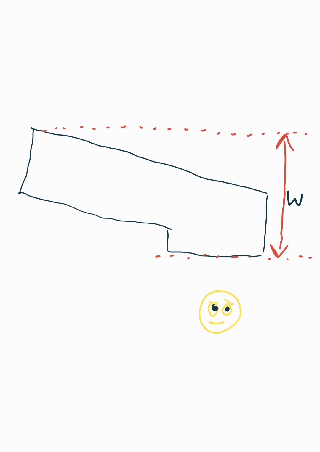

:rolleyes:
@ Woody Assuming the short wall next to the "W" is the front of the house (as it is on the OP's drawing) then your method of measurement is identical to mine, though your angle is more obtuse.
So what are we arguing about?
That's exactly the same as Tony's first sketch.
It's the widest point as measured along any line parallel to the frontage. Or to put it simply, it's the smallest gap the house would fit through, keeping it in exactly the same alignment, not twisting it.
Obviously it's not ANY direction, because that would clearly be the front left to back right corner, which would be stupid.
So in TMM7, the measurement of the width is actually less than half the width because you don't actually measure the long section of the wall?

What's TMM7?
QS much? :rolleyes: I'm wasted here.
Tony's Method of Measurement 7.
Strictly we should be using NRM nowadays, so perhaps I should have referenced TRM. Apologies
