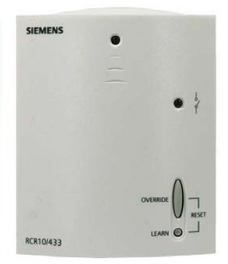

It's radio control, and the other part of it is one of these:
wired to the boiler. Pressing the Override button should activate the boiler immediately.

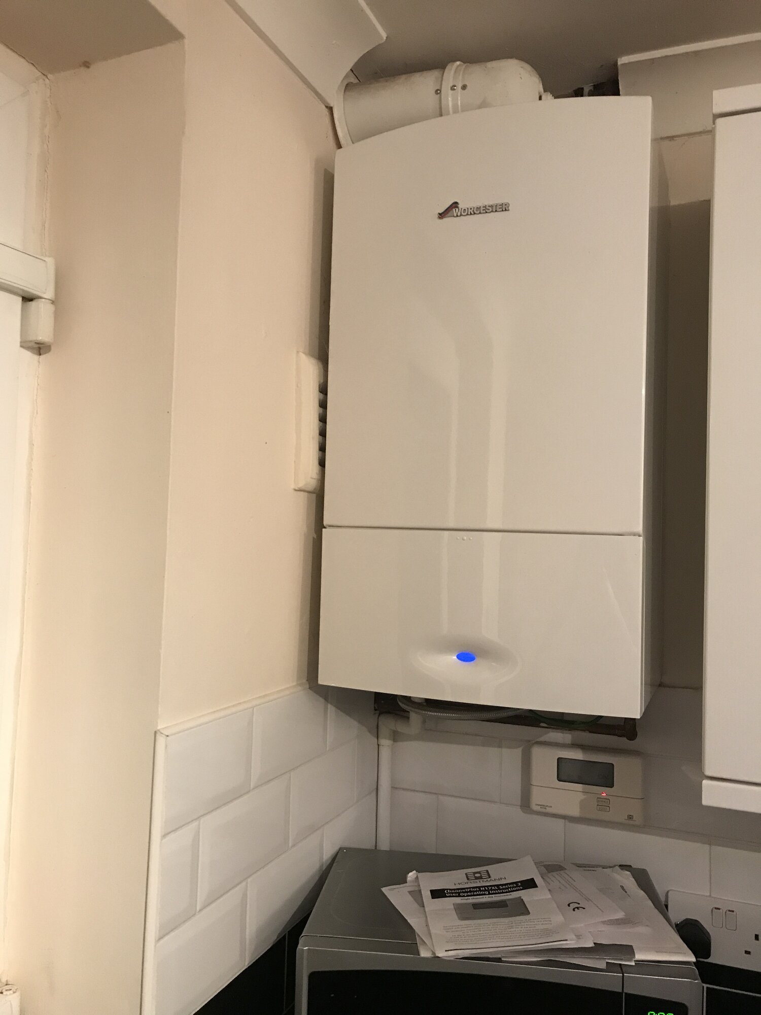

What boiler do you have ?
Some pics of around boiler ,and hot water cylinder ( assuming you have one) would be helpful.

The boiler is a Worcester and I’m not sure if it’s relevant but we’re on LPG gas as the village has no gas mains. We do have full bottles and water is being heated on demand.
EDIT: inside boiler has a more specific label - Greenstar 24i junior combi MK IV if that’s helpful!

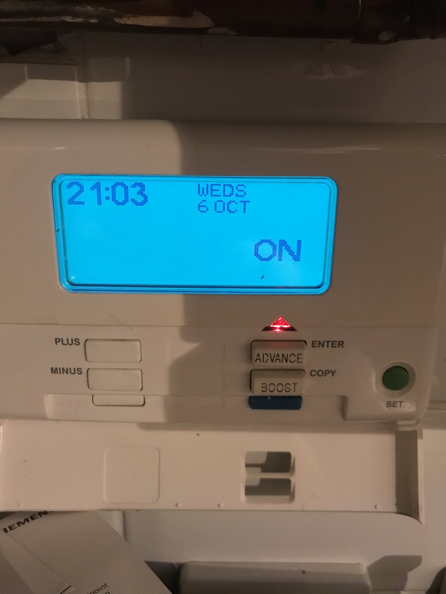

Lower the flap on the timer and show us a close up ,in focus pic,of the display. It appears that the stat isn't doing anything ,just stuck on the wall somewhere....odd.
There’s only a couple of setting options - On, off, auto on and all day, the last two of which you can set times for
EDIT: advance and boost don’t seem do anything. Boiler only kicks in when hot tap is turned on. And twice it’s come on at midday for an hour ish for radiators

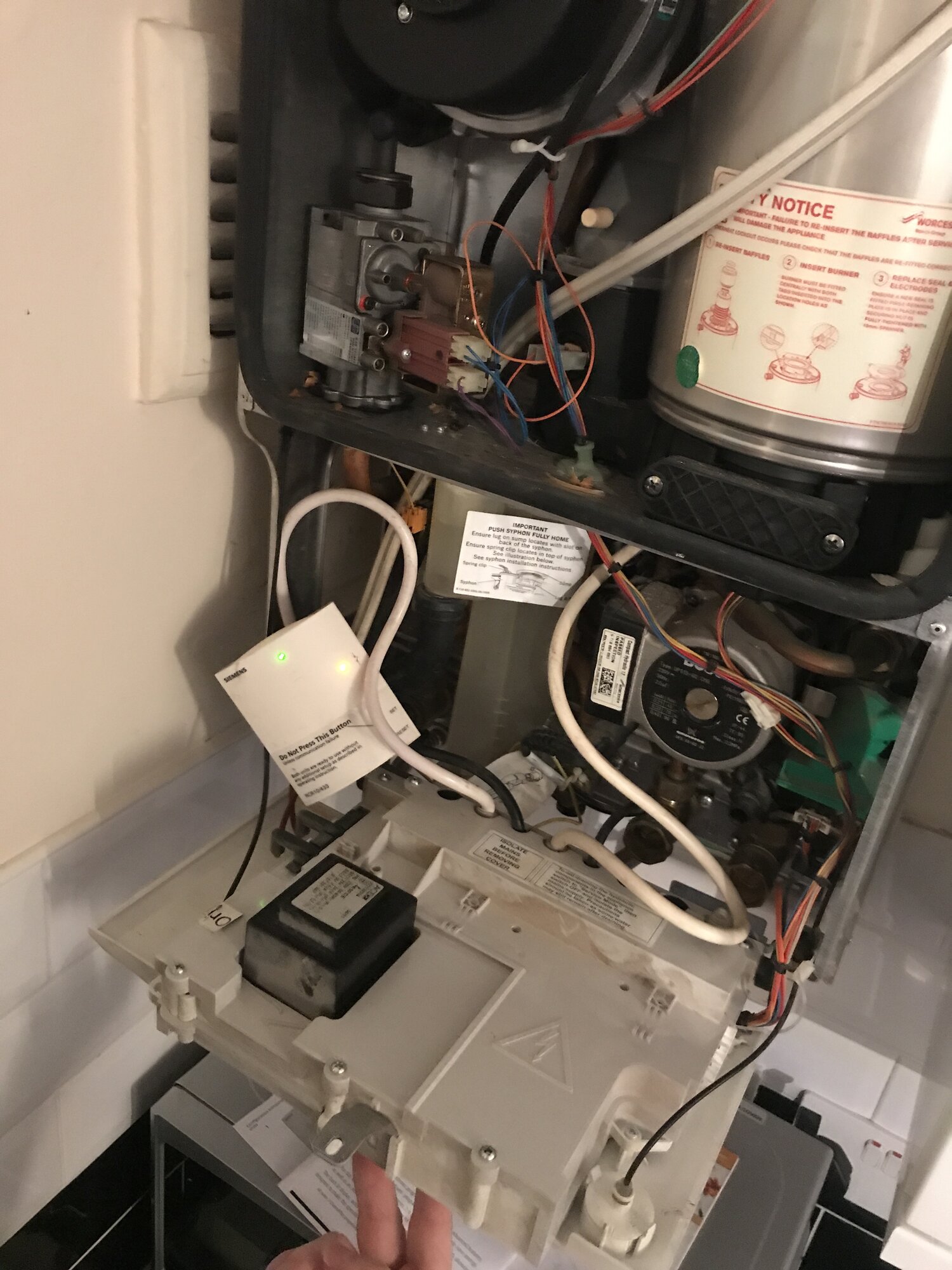

Can’t get them to talk to each other but at least we’ve found the other bit I guess?
We can’t get it out of the boiler without rewiring it….I’m guessing it probably shouldn’t be stored there?
You shouldn't really have removed the boiler casing. I have never seen a receiver placed within the boiler like that ,and to be frank can't see why would want to.
We followed the instructions to remove the front and haven’t touched anything else in there, I can’t see how else we could have gotten anywhere
Well ,you are where you are. Have you got your boiler working ?
Nope! Reset the two Siemens devices and paired them up but the boilers not responding to the thermostat settings. However I’m no longer baffled by the setup as a whole and will try more trouble shooting tomorrow
