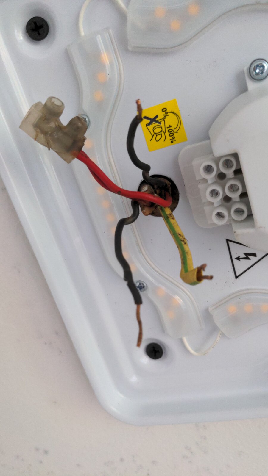

Hi,
I'm fairly competent with simple household electrics, swapping things, adding a light or socket, but what appeared to be a simple swap has made me rethink my electrical abilities!
The old fitting was a simple bayonet lampholder, wiring shown below: 2 black cables into the fitting, 2 reds terminated, 2 earth's sheathed.
I believed that the 2 blacks would be switched live, and neutral. I tested, probably poorly, for the switched live, thought I had it. Wired that to the L of the new fitting, as shown. The other black to N, and the earth to E. The new fitting is a basic LED ceiling light if that helps. It is not a dimmer switch.
Turned the electric back on, when I switched the light on, buzzing and flickering from I believe both the fitting and the switch. Quickly turning it off, and believing I had made a mistake, I switched the L and N. Electric on, switch on, same if not worse flickering/ buzzing.
Put the old fitting back on, and works fine.
Any ideas or is it professional time?
Thanks, Dave
There's nothing obvious that you've done anything wrong, especially if the old fitting works. The choc block does look like it's heated up somehow - check that in the first instance and then the switch
Can you get a piece of flex & wire the light(s) into it and attached a plug on the other end ... plug that in to see it the lights work ok?
The fitting is new, but I guess that's definitely a possibility. I'll try a replacement
Looks like there is a slit in the insulation of one of the black wires,and one of the reds has a mark on it too. The connector block is decidedly dodgy ! Was it like that on the original fitting ?
Did any fuses blow or breakers trip ?
All the nicks, and the melted block were in the original fitting, which looks to be at least 20 years old, if not more. No fuses blew, and the MCB remained on. The buzzing and flickering made me switch the light off quickly. Thanks, Dave.
Check the fitting out first. Then give the copper cores of all the wires a good tug with a set of pliers just to make sure there isn't a random air gap in there (they look very twisty)

When you reconnected the old fitting that worked fine, did you connect the blacks across the lamp, the reds to each other and the two earth conductors likewise?

Suspect the reds are badly connected. The crackling will be the circuit arcing.
Turn off all power and check for dead.
Reconnect the reds securely in a new connector.
While you're at it, use your multimeter to identify which black is the switched live, and mark it accordingly.
If after reconnecting the supply, the fitting is still inop, then I would swap it.
Thanks for your replies securespark. The shown wiring is exactly how it came out of the old lampholder. The earth's, and reds remained unchanged from old to new and vice versa. While I wouldn't be happy keeping the wires as they were with nicks and a melted connector, I tested the new fitting expecting to come back and clean up the wiring.
I'll do all these little bits, test properly, and hope this fitting works. I have another replacement ready just in case, and I'll flex test the first one if it fails again for interest.
