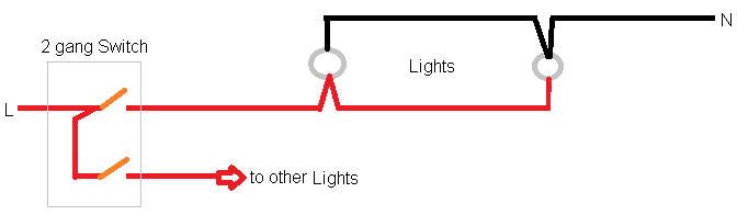

I'm making a guess BUT Istress it is ONLY A GUESS you may have this arrangement:
Unless you have any test kit and are able to use it with a modicum of accuracy I don't have a starting point for offering advice on what tests to do/where to start.
