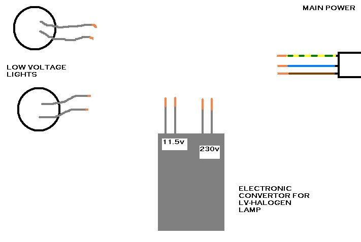

I have a cabinet that has 2 low voltage lamps in it, it came with the convertor but i am unsure how to wire it up, it has 230v written on one side but it does not state which is live and which is neutral??
Also if i want to fit a small rocker switch in the cabinete where would this wire between?
If you could edit my drawing that would help me the most!
Thanks for your time
Jose
230v to the 230v side, ELV lamps to the 11.5v side, all connections in suitable enclosures
Doesn't matter what way round the ELV connections are, and if the LV ones arn't colour coded, then the same applies to them, if the SMPS is metal cased and class 1 then connect the CPC to this, if not connect it in a spare connector in whatever enclosure you are using
ELV = Extra low voltage (sub 50v)
LV = low voltage (50v-500v)
SMPS = Switch Mode Power Supply
CPC = Circuit Protective conductor (earth)
hi, on the convertor it does not say on the 230v side which is Neutral and which is Live, des it matter which way round they go?
